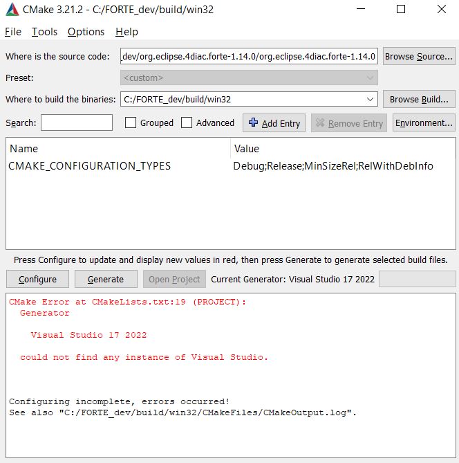

I have a configuration problem in CMake. He gets such an error in response - i add in attachment. What is caused by how can it be solved?
Best regards
Michal

which C++ compiler have you installed on your machine?
Cheers,
Alois
Re: Problem with configure in CMake [message #1844654 is a reply to message #1844653] Mon, 20 September 2021 08:51 Go to previous messageGo to next message
if VS 2022 is installed on your machine, then the compilers are not visible on the PATH.
Try starting CMake via the Visual Studio Native Tools Command Prompt.
Martin

I use MinGW-w64 compilator. My hardware supplier using 4diac but I need to give it new functionality, I need to add modbus library
[Updated on: Thu, 23 September 2021 10:38] by Moderator
Re: Problem with configure in CMake [message #1844742 is a reply to message #1844737] Thu, 23 September 2021 12:44 Go to previous messageGo to next message
If you use MinGW compiler you must not select a visual studio project in cmake but either unix make files or I think there is also a mingw project. The latter I have never tried. Please have a look in our docs on how to build 4diac FORTE with mingw.
