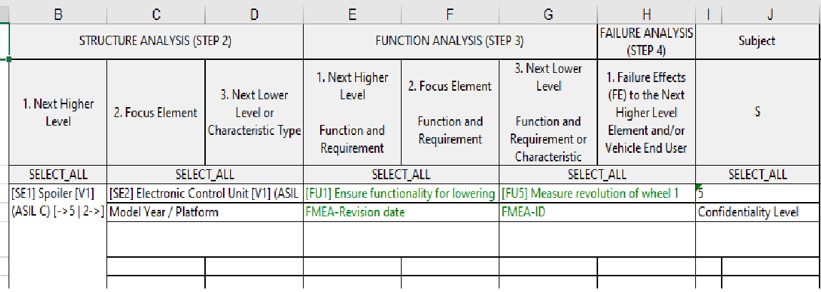

I am trying to use the natExporter.exportMultipleNatTables method to export two different nat tables to the same excel sheet.
My problem is that they are always overlapping, since each layerExport starts at row 0. Can I somehow export them underneath each other?
Is this a problem of what layers are used in each nat table?
In the attached files there are the nat tables in the application (looking fine) and beneath is the export, where the cells are overlapping.
I'm using Version 1.8.
Any bit of help would be appreciated!
Marius

You're right. I was using 1.5. Sorry for the confusion.
I also used a custom version of the PoiExcelExporter. The reason for the problem was that it didn't correctly use the "this.currentRow" instance variable. I changed the code so that the function "exportCell" uses it correctly and now it works!
