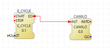

I am a student of electrical engineering, and I am currently working in a company that handles NOJA POWER recloser equipment, which has an integrated automation system using 4DIAC (similar to the PLC). That is why I took on the task of learning how to create FB using FORTE. When I managed to create and make them work within the 4DIAC (SGA) the following problem occurred to me:

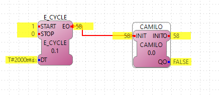

The new FB only works with the ip of the forte (127.0.0.1), which is a problem, since when I try to integrate the code in the machine (create the FORTE boot-files and integrate it in the machine) exactly that function that design, it doesn't work.
Does anyone know, how can I integrate these new FBs in those computers?

Currently when you are creating your own FB you need to generate C++ code for it and recompile a 4diac FORTE. As you have this working on the lokal host I think you know how this works.
Now coming to your NOJA Power device. In order to get your FB into the NOJA Power device you wold need to be able to change the 4diac FORTE they have integrated. For that I fear you have to get into contact with them.
I hope this helps.
