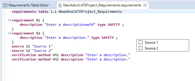

Oh sorry, by Editor I meant an Eclipse editor. So in the attached image, the editor tab "Requirements Table Editor" has a NatTable in it, and a ComboBoxCellEditor was opened.
Then, I clicked on the tab NewAdvoCATEProject_Requirements.requirements to open a text editor, and the ComboBoxCellEditor is still visible in the text editor.

Ah ok, but still the combo should then close automatically because it looses the focus. At least it should.
Have you verified that the click on the tab causes a focus lost event? For scrollbars I remember that it didn't happen so I needed to add some special handling.
