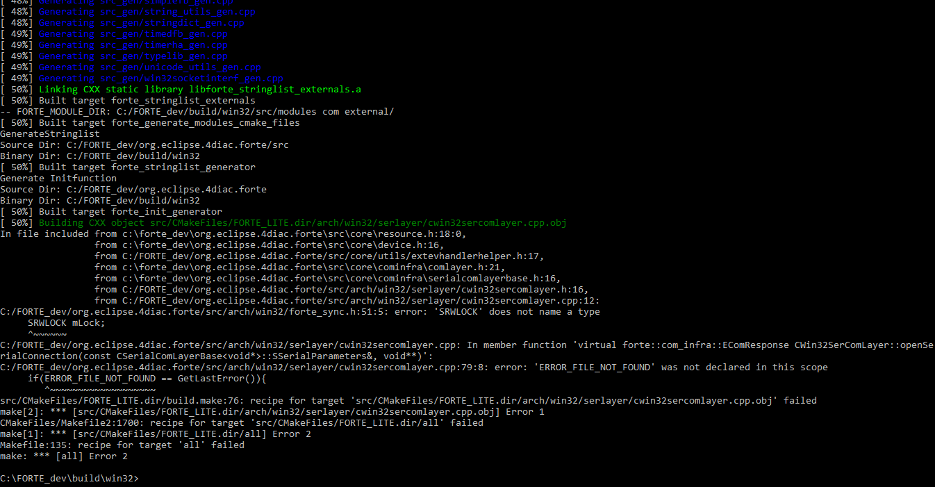

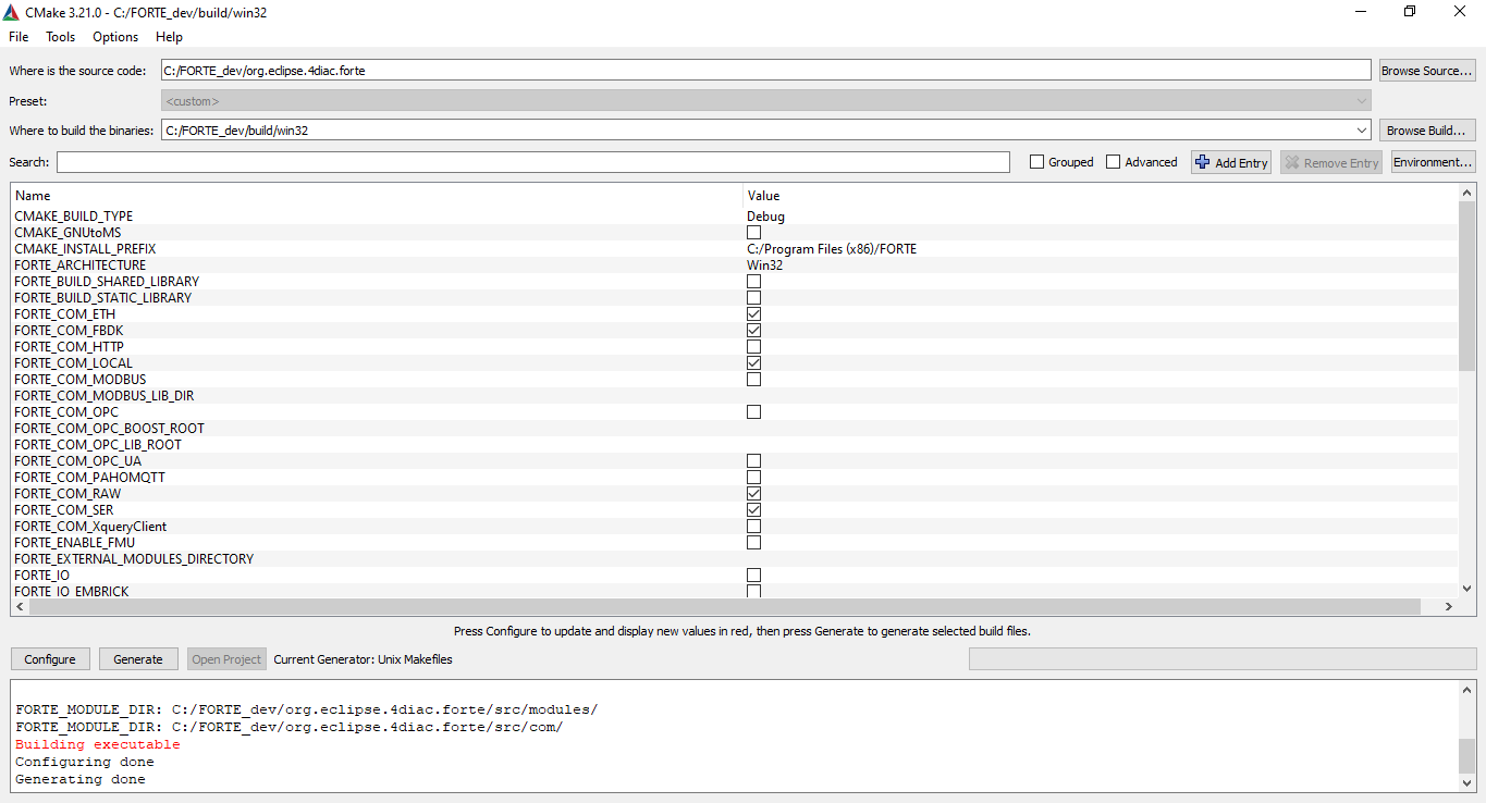

When creating Forte as https://www.eclipse.org/4diac/en_help.php?helppage=html/installation/install.html
Always getting errors (cmd.png) while compiling, after generate files in cmake (cmake.png)
Any Advise?

Re: Create Forte Compilate Error [message #1843401 is a reply to message #1843396] Tue, 27 July 2021 16:35 Go to previous messageGo to next message
Which compiler are you using?
Re: Create Forte Compilate Error [message #1843410 is a reply to message #1843401] Wed, 28 July 2021 03:57 Go to previous messageGo to next message
MinGW-w64
Re: Create Forte Compilate Error [message #1843490 is a reply to message #1843410] Mon, 02 August 2021 07:25 Go to previous messageGo to next message
For tests can you deactivate the FORT_COM_SER as I don't think you will need it.
Re: Create Forte Compilate Error [message #1844275 is a reply to message #1843490] Tue, 07 September 2021 15:32 Go to previous message
I have the same problem, could you solve it?
