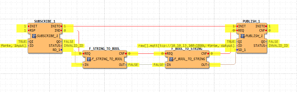

I am trying to use MQTT to subscribe and publish some values, but i always get "Invalid ID" or "No Socket".
Subscribe ID: raw[].mqtt[tcp://10.10.13.107:1883, forte, input]
Publish ID: raw[].mqtt[tcp://10.10.13.107:1883, forte, output]
I use a mosquitto broker, that is in another computer and it´s working .
Any advise?
And what is CientID?

Dumb question: you have enabled the raw communication layer and the mqtt communication layer when building the FORTE you are using?
Re: MQTT Invalid ID [message #1843386 is a reply to message #1843375] Tue, 27 July 2021 05:27 Go to previous messageGo to next message
Probably not, how and where i do that?
Re: MQTT Invalid ID [message #1843400 is a reply to message #1843386] Tue, 27 July 2021 16:31 Go to previous message
You should find all you need here: https://www.eclipse.org/4diac/en_help.php?helppage=html/communication/mqttPaho.html
