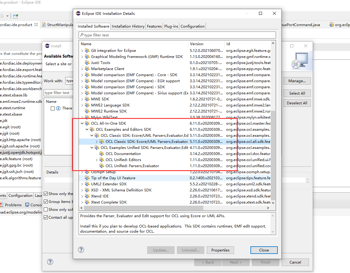

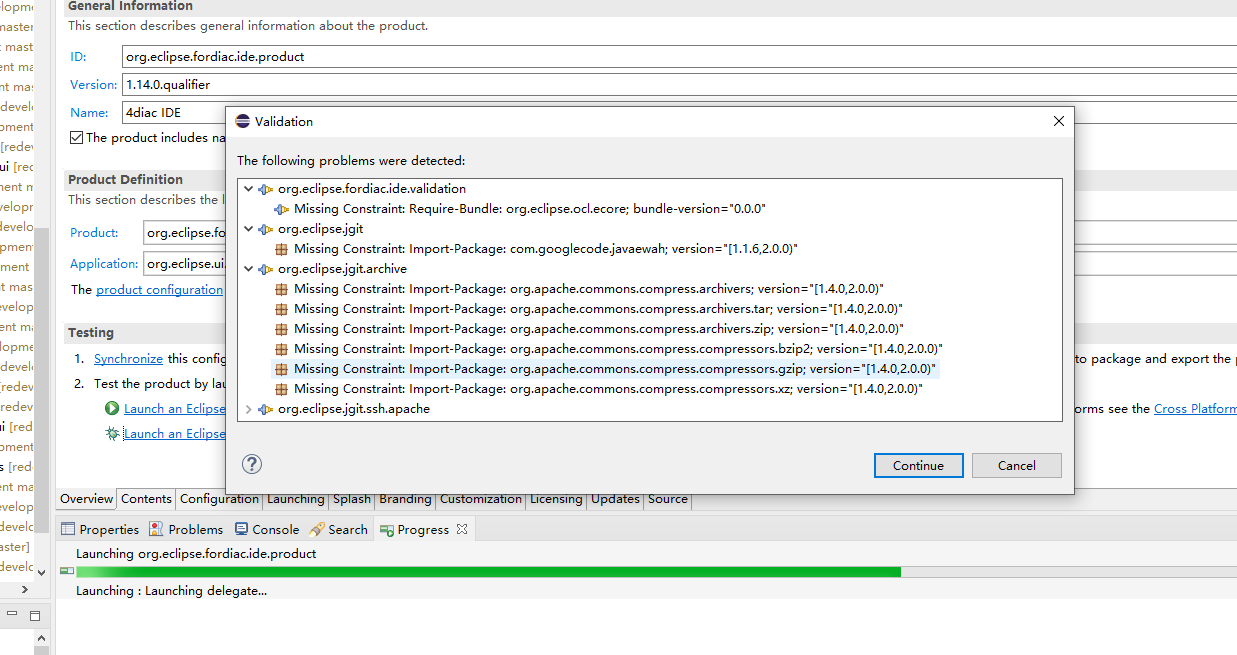

always report :require-bundle org.eclipse.ocl.ecore
actually,I have already installed ocl.sdk

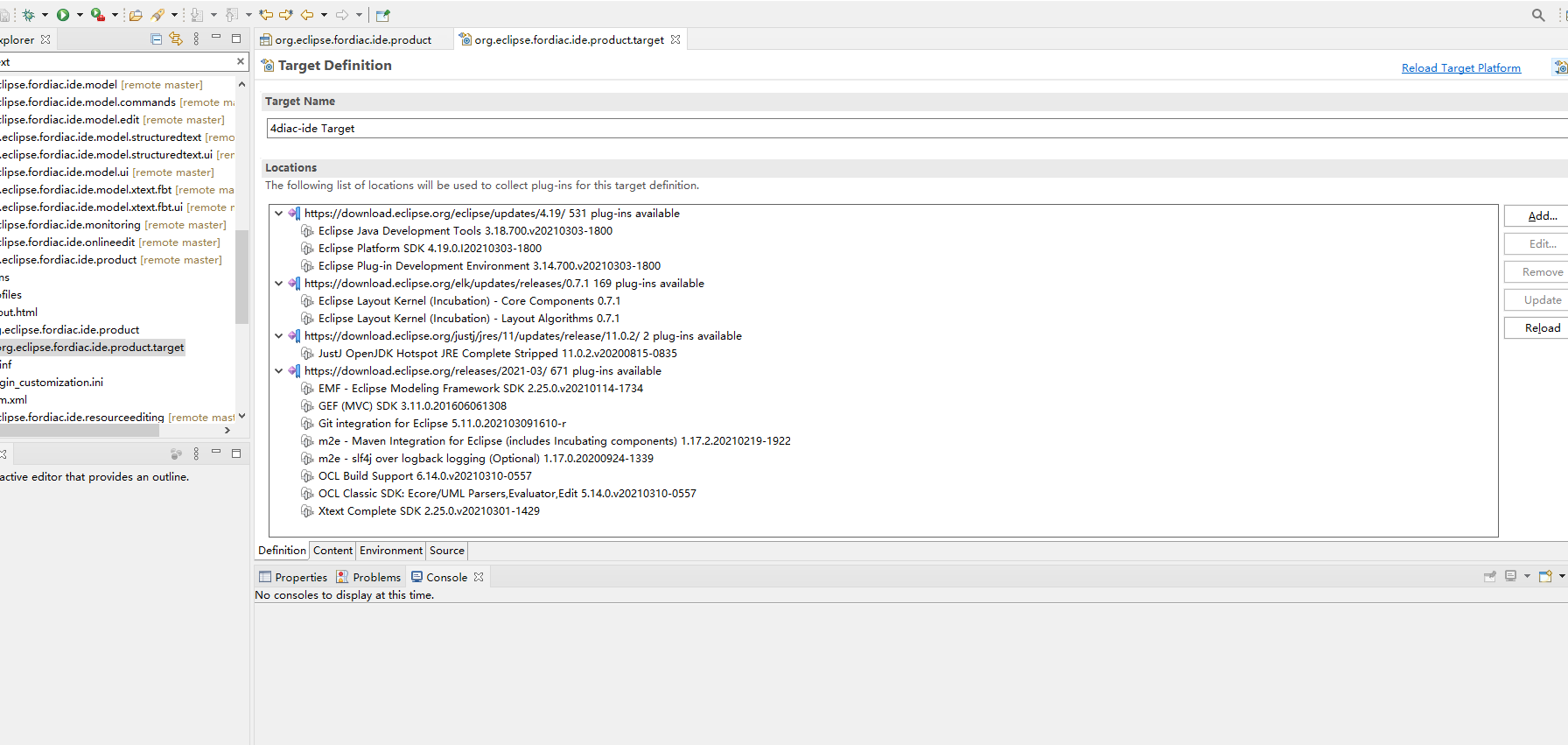

have you loaded the target platform and set as active target platform as discribed in our documentation?
Re: Help! Can not run the ide source code1.14 [message #1843363 is a reply to message #1843359] Mon, 26 July 2021 03:57 Go to previous messageGo to next message
Is this?
index.php/fa/40800/0/
  • Attachment: response.png
    (Size: 108.63KB, Downloaded 271 times)
Re: Help! Can not run the ide source code1.14 [message #1843373 is a reply to message #1843363] Mon, 26 July 2021 15:50 Go to previous messageGo to next message
No we provide a target definition file. As described in the documentation you need to load it and set it as the target platform to use.

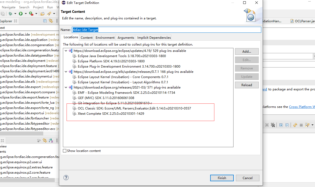

Re: Help! Can not run the ide source code1.14 [message #1843382 is a reply to message #1843373] Tue, 27 July 2021 04:20 Go to previous messageGo to next message
index.php/fa/40802/0/
this page?
  • Attachment: target.png
    (Size: 105.98KB, Downloaded 244 times)
Re: Help! Can not run the ide source code1.14 [message #1843399 is a reply to message #1843382] Tue, 27 July 2021 16:23 Go to previous message
Yes. this is the page. Any reasons why you modified it? The provided version should work out of the box. At least it does for most sofar.
