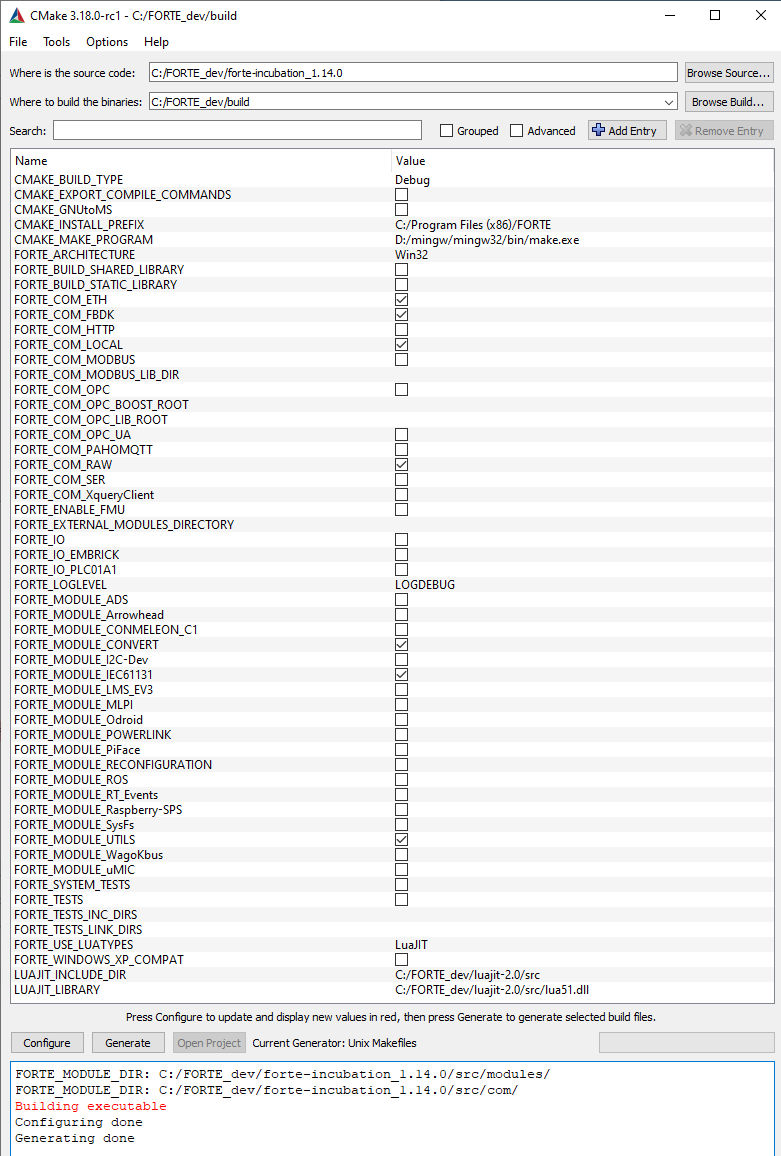

I tried to follow "Step 7 - Deploying new FBs with the Dynamic Type Loader".

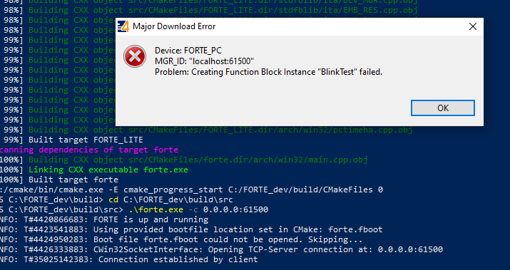

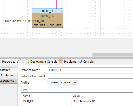

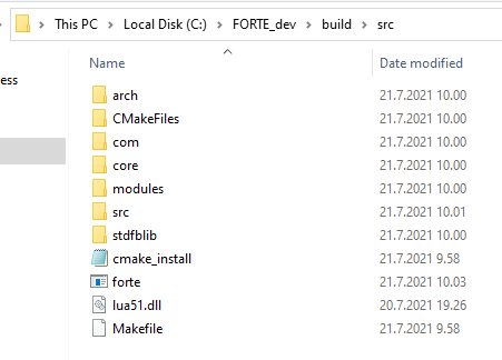

I can successfully compile Forte with LuaJIT, and change the device profile to DynamicTypeLoad, but finally, encounter the deployment error "Creating function blocks failed" when deploying customized basic FB.

- CMake configuration for luajit
- Forte with lua51.dll in the build folder

- Deployment error

!ENTRY org.apache.log4j 4 0 2021-07-21 14:32:40.078
!MESSAGE org.eclipse.fordiac.ide.deployment.iec61499.DynamicTypeLoadDeploymentExecutor - Create Type "LUA script" failed.
!STACK 0
java.net.SocketTimeoutException: Read timed out

as stated the lua part needs more work. It looks like there is some issue in either the lua generation or during sending. One thing that you should do in your CMake configuration under the andvanced options is to increas the recieve buffer size. Furthermore would it be possible to give us the FB for a further assessment?

Hi Alois. Thanks! By increasing the buffer size in CMake, it works now.
