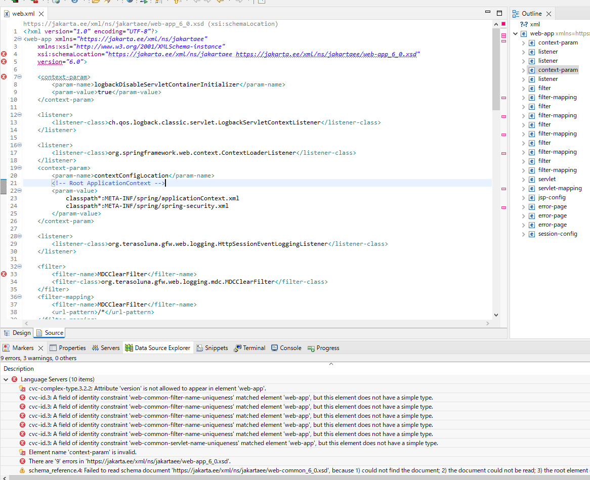

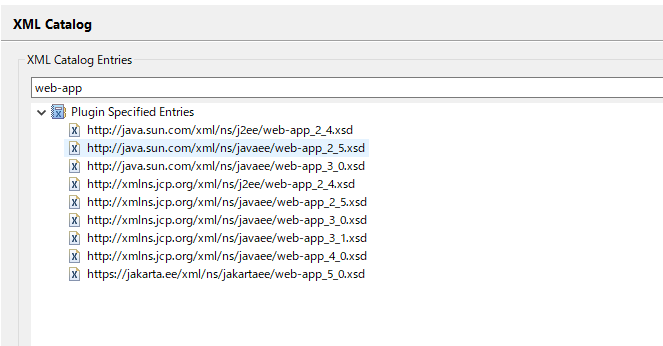

There seems to be no https://jakarta.ee/xml/ns/jakartaee/web-app_6_0.xsd in Eclipse 2023-03 M2
index.php/fa/42929/0/
Web.xml will have errors without network
index.php/fa/42930/0/

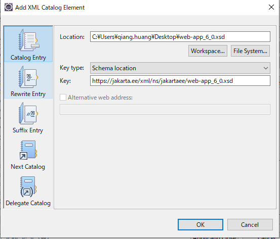

I tried to add it manually, but there are still errors
index.php/fa/42931/0/
index.php/fa/42932/0/
Is there anything missing when I manually append...

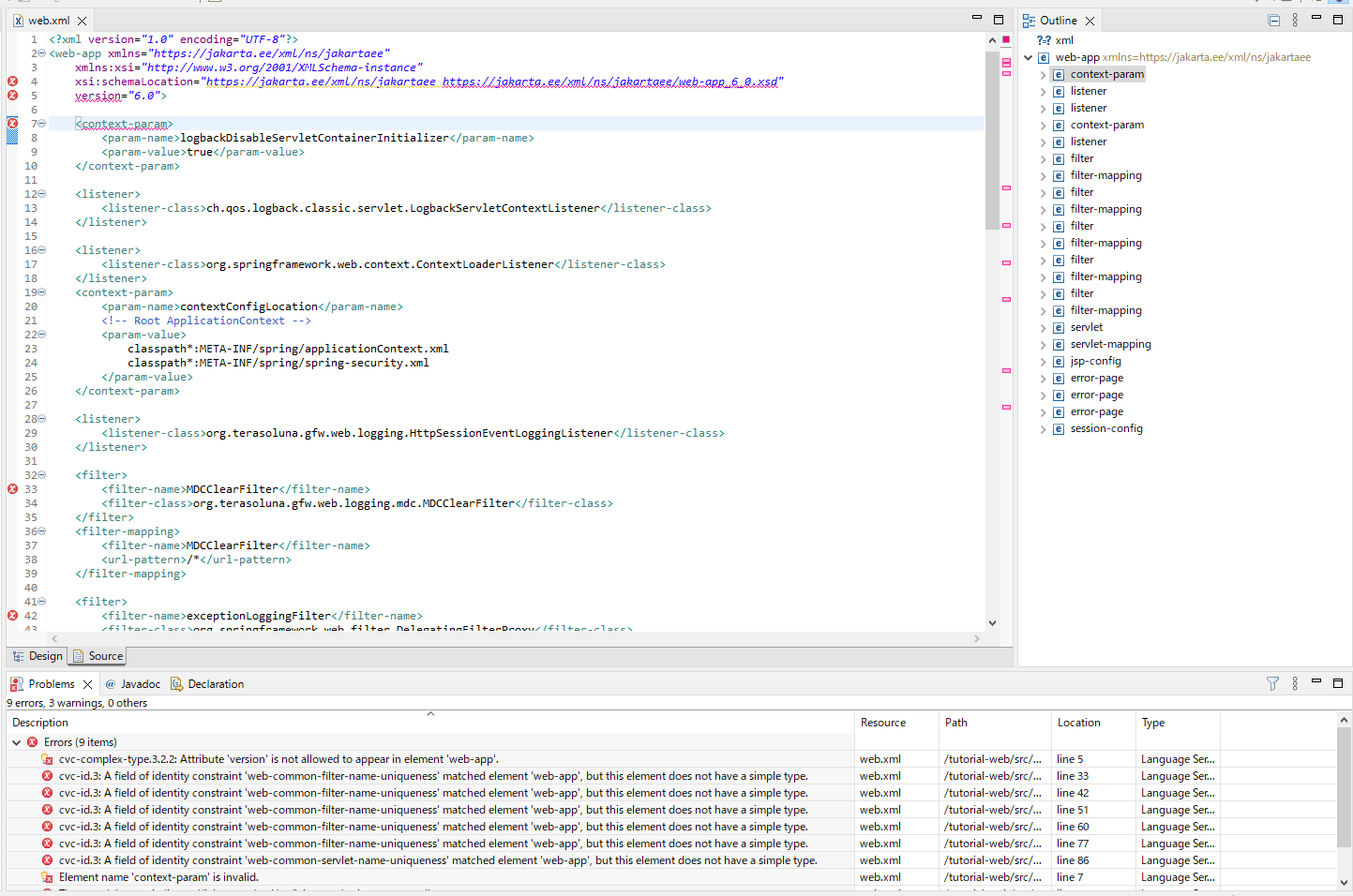

I tried RC1
6.0 has been added
Other errors occurred,It seems to be related to jakartaee10
index.php/fa/43003/0/
It is really difficult to migrate from javax to jakarta,I will wait for the next release

This issue still exists in Eclipse 2023-06
When using Servlet 6.0/Jakarta EE 10 and without a network, web.xml may have errors:
Referenced file contains errors (jar:file:/D:/eclipse-jee-2023-06-RC1-win32-x86_64/eclipse/plugins/org.eclipse.jst.standard.schemas_1.2.500.v202302261818.jar!/dtdsAndSchemas/jakartaee_10.xsd).
The display in 「Show Details」 is as follows
schema_reference.4:Failed to read schema document "https://www.w3.org/2001/xml.xsd",because 1) cloud not find the document;
2) the document cloud not be read; 3) the root element of the document is not <xsd:schema>.
src-resolve:Cannot resolve the name 'xml:lang' to a(n) 'attribute declaration' component.
