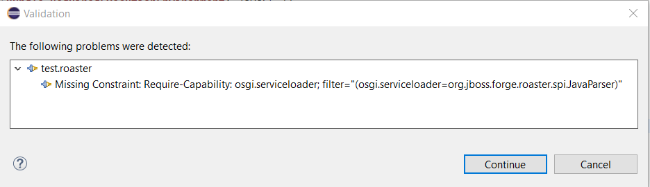

In the main package, I created a Junit class to test this and this error arises.
index.php/fa/40700/0/
Am I missing something? I uploaded the minimal example so you can take a look if you have the time to do so (test-roaster.zip).
Thanks in advance!

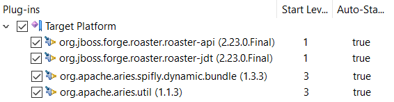

Re: Tycho + Target Platform + ServiceLoader [message #1842981 is a reply to message #1842719] Thu, 08 July 2021 10:05 Go to previous messageGo to next message
Hi Thomas and Ed,
Thank you so much for taking the time and help me with this. Indeed, I was confused with the consumer and provider concept.
Based on the example that @Thomas uploaded I was able to mimic this on my application. However, I have to change the start level and autostart of apache aries and jboss like this:
index.php/fa/40740/0/
The thing is that I am implementing a plug-in for Eclipse. Therefore, I was wondering how to programmatically do this so that it works for users when they installed the plugin. Should I activate programmatically aries and jboss somehow? What should be the best approach?
Thanks!
Kind regards,
Antonio
