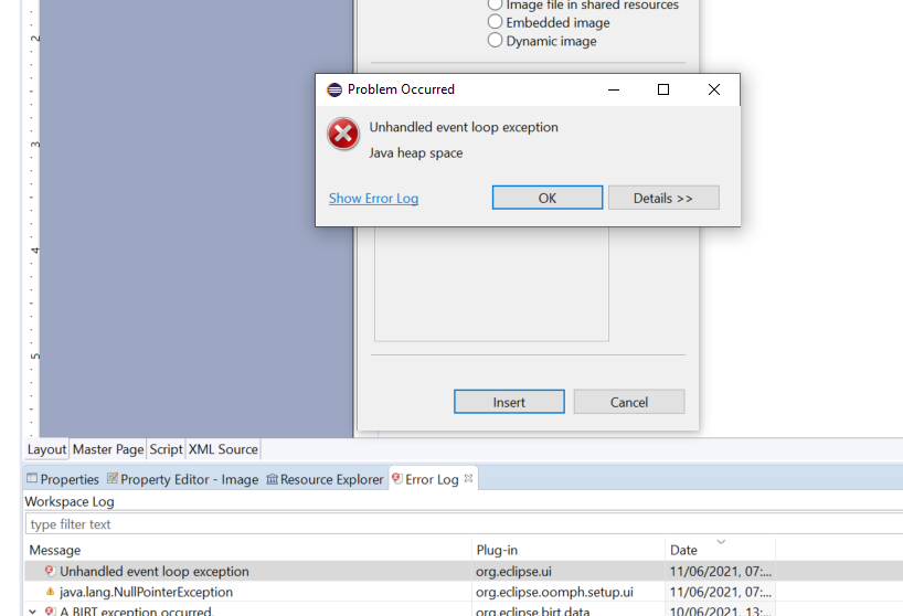

I am trying to retrieve an image for my birt report from AWS but everytime I put in the URI and click Insert I get this error: (See image 1)

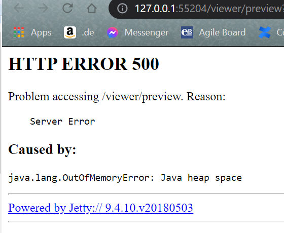

Then when I click ok: (See image 2)

You've run out of memory. Add a line like this to your eclipse.ini, after the -vmargs line, to increase the size of the heap:
-Xmx4g
