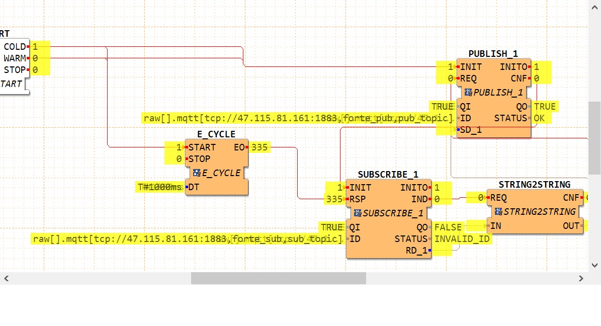

when i use mqtt in 4diac, if just use one subscribe or one publish, that's ok. but if i use both subscribe and publish at the same time, one of them will return INVALID_ID.
is there anything wrong for paho mqtt config?
thx a lot!

oh, how silly am I. Watch the code and understand that all FBs need use the same clientID....
Re: mqtt question, help pls [message #1842100 is a reply to message #1842094] Wed, 09 June 2021 05:49 Go to previous messageGo to next message
Just wanted to write that. Unfortunately you have to give in all places the same clientedID and also the same broker address. We haven't found a better solution yet.
Re: mqtt question, help pls [message #1842102 is a reply to message #1842094] Wed, 09 June 2021 06:22 Go to previous message
Correct, at least for all blocks which will run on the same device
