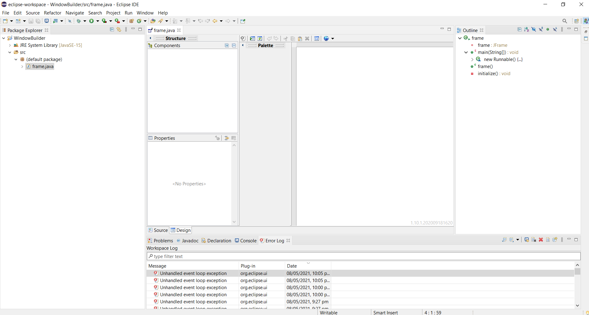

hi,
I really appreciate for those who respond this..
I use windows 10 as operating system and installed eclipse version 2021-03 (4.19.0).
I have done install the windowbuilder plug in. but when I open the design menu button, the palette component is empty.
I have tried so many solution such as reinstall the plug in window builder until reinstall the eclipse software but it still did not work and the palette component still empty.
when i click the design button, this 2 error is shown in the error log:

I have uploaded the screenshot of empty palette.
hope someone can give me solution for this problem.

Re: windowbuilder [message #1841425 is a reply to message #1841258] Sun, 16 May 2021 04:17 Go to previous messageGo to next message
See:
https://bugs.eclipse.org/bugs/show_bug.cgi?id=572210
If I add
--illegal-access=permit
to the Eclipse.ini it seems to work (with OpenJDK 16).
