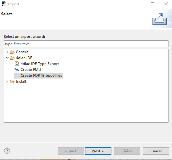

environment: 4diac ide: 1.13.1
in 4diac ide 1.13.1,i can't export forte boot file.
My steps are as follows:
1.right click on my project and chose 'export'
2.in 'explort' screen,chose 4diac IDE->Create FORTE boot-files->Next

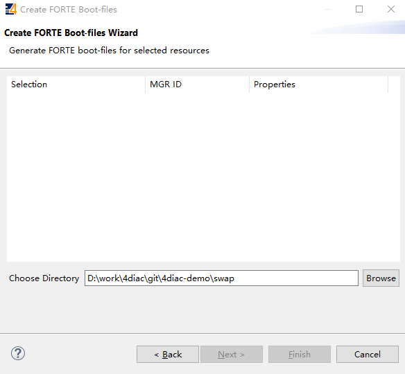

3.in 'Create FORTE Boot-files' screen,click 'Browse' to chose directory
then there's nothing i can do,and the 'Filish' butten is disabled.I don't know if anyone else has a similar problem?

hi,
yes this is a known problem, which has been reported already several times in the forum. Also a bug has been added to our bugzilla: https://bugs.eclipse.org/bugs/show_bug.cgi?id=568326
