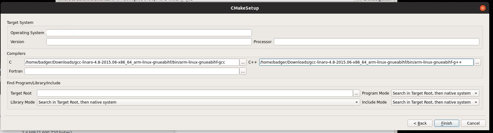

I am currently cross-compiling code that already compiles and works fine on my 4diac/FORTE under Ubuntu 18.10 (64-bit Linux)
However, the standard libraries suggested in the 4diac documentation for cross-compiling for the Raspberry Pi are not for c++11. While a lot of my existing code is compiling fine, I am getting errors like this when I cross-compile:
/home/badger/org.eclipse.4diac.forte/ExportedFBs/HVAC_Pi/Z_DISPLAY3.h:70:9: error: 'constexpr' does not name a type
static constexpr const char* END_OF_PACKET = "&";
/home/badger/org.eclipse.4diac.forte/ExportedFBs/HVAC_Pi/Z_DISPLAY3.h:70:9: note: C++11 'constexpr' only available with -std=c++11 or -std=gnu++11
The current libraries I am using are shown inside CMake in the attachment.
Does anyone know the correct C++ libraries I should be using for C++ 11?

Great that you could get it running. The problem is not a library issue. We are constantly trying to improve the code quality of 4diac FORTE and by that also using more and more modern C++. In order get it working you need to add the "-std=c++11" (without the quotes) to your c++ compiler flags.
