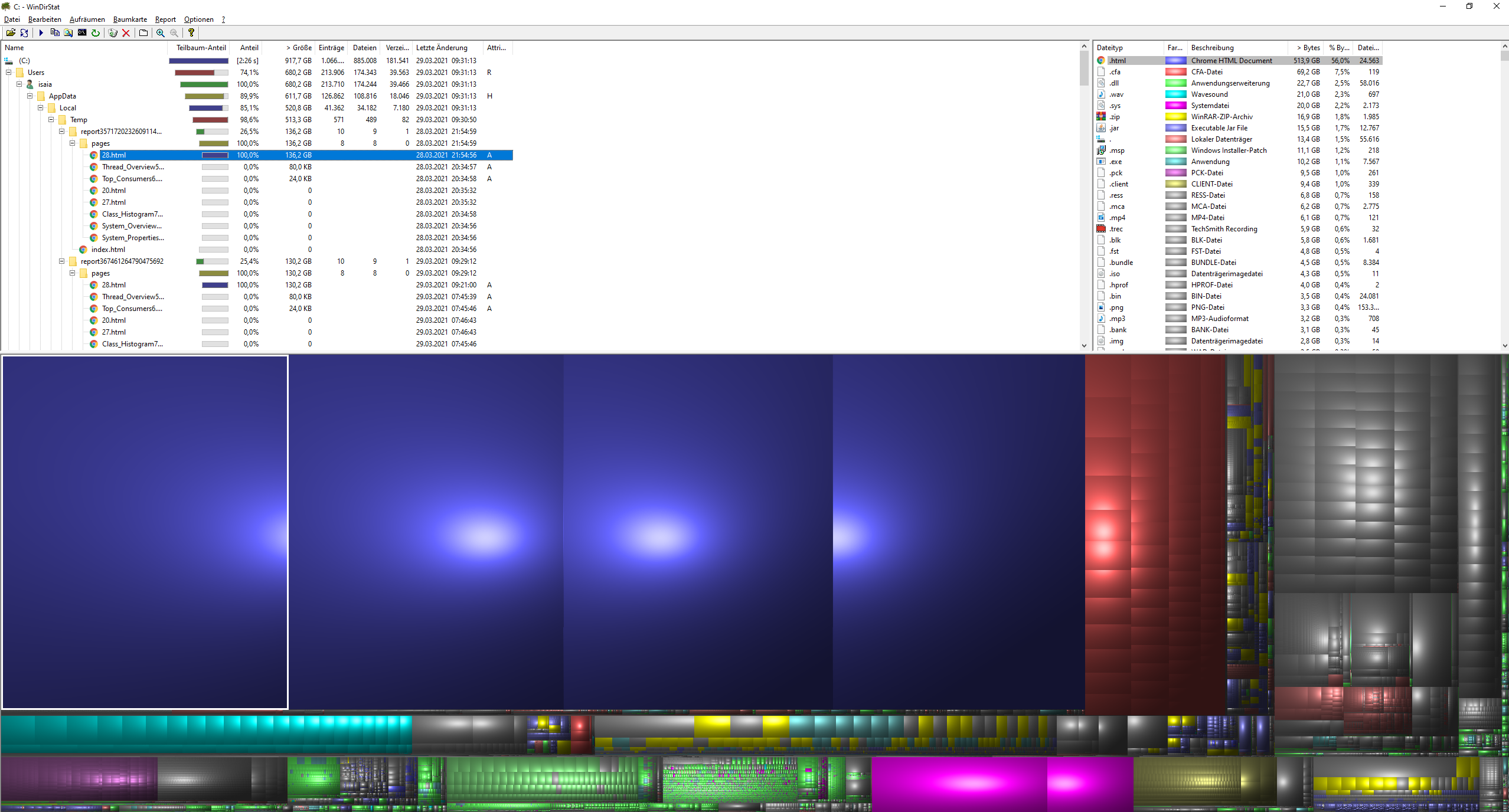

I was about to analyse a heap dump from my Moded Minecraft Server and the Leak Suspect Report never finished loading and I had to stop the programm caus my SSD was out of storage, becaus of the huge html file it produced.
Here you can see it in WinDirStat
index.php/fa/40238/0/
I used the standalone installation of Eclipse Memory Analyzer and got the Version 1.11.0
Uh and I cant uploade the hprof file becaus its 4 GB, but I will find a way to share it if necessary (which makes sense).
Also I made another heap dump of the same Server and with that one everything was fine. So it has to be a special problem with this particular dump I guess.

That huge file is not right.
Is there a way you can extract the first part of the huge file ? You will need to delete one of those huge report directories so you have some free disk space and then run, for example, from PowerShell:
gc -Delimiter ">" -TotalCount 50000 .\28.html >28short.html
We can then see which part of the report is so big.
If you can compress the HPROF file (with zip, gzip etc. or in Windows send it to a compressed folder) then that might make the file more manageable to upload somewhere.

Thanks. I think I have an idea what has gone wrong.
It is in 'Thread Stack and Involved Local Variables' where a tree is being continually expanded.
It is meant to show the thread, which is expanded to show the stack frames, and the the stack frames which have a reference to the leaking object, but the objects are being expanded too.
I have opened a bug:
572491: Leak Suspect Report makes huge file
