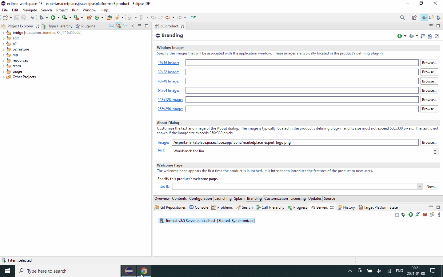

I got it. This is what I wanted to achieve: installing plugins with P2 UI on the platform with RAP. Well, it's a bit stressing but Eclipse is a great product, and with some patience things finally work.
