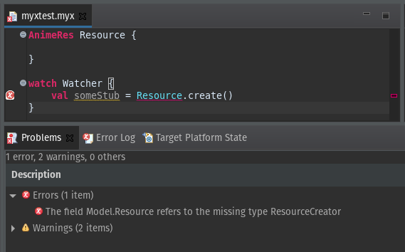

Shortly, the problem is that when I'm writing my dsl file (with grammars inherited from xbase), I may need to use some classes, that are surely to be generated after the validation but that are not available during writing the file.
The question is, how do i configure Xtext and Xbase in order to use in my DSL file (the one with DSL extension, ".myx") classes that are not yet generated by JvmModelInferrer?

The problem that I've faced with this approach is shown in the attached screenshot index.php/fa/39535/0/
So it seems that some linking fails but I can not understand what I should do to fix that and what bindings I should override and how.
Any help would be appreciated.

can you please provide a jvmmodelinferrer that actually compiles
cross post from https://stackoverflow.com/questions/65278762/xtext-use-generated-classes-in-dsl-file-problem-of-missing-type
