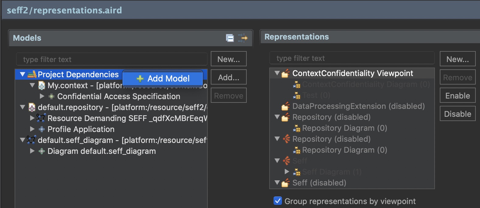

I am relatively new to Sirius and I want to programmatically add a model of a different Modeling Project to the Project Dependencies of another projects representations.aird file.
Manually I am able to do this (see image) but I would like to programmatically set this dependency within an External Java Action.
I would be very grateful for any help!

Hi Cynthia,
The code of the corresponding action is here: AddModelDependencyAction. This action uses AddSemanticResourceCommand through SemanticResourceAdditionOperation.
A code like below should do the job:
org.eclipse.sirius.business.api.session.Session session = ...;
org.eclipse.emf.common.util.URI semanticResourcesURI = ...;
session.getTransactionalEditingDomain().getCommandStack().execute(new AddSemanticResourceCommand(session, semanticResourcesURI, new NullProgressMonitor()));
Laurent
