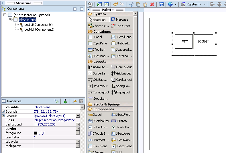

I am using Eclipse Oxygen (4.7.3a) and WindowBuilder 1.9.1.201710100405 on Windows 7 (32 bit) with Oracle JDK 1.8.0_201 (32 bit).
I wrote a class that extends javax.swing.JPanel. This class contains a single member which is javax.swing.JLayer. This JLayer decorates a javax.swing.JSplitPane because I wanted a special divider for the JSplitPane and I managed to implement the special divider using a combination of JLayer and another class that I wrote which extends javax.swing.plaf.LayerUI.
I then wrote a BeanInfo class for the above component. The BeanInfo class contains property descriptors for three properties:
1. the left component for the JSplitPane
2. the right component for the JSplitPane
3. the divider orientation for the JSplitPane
My class, that extends JPanel, does not have an actual left component member nor a right component member nor even an orientation member since these are all really properties of the JSplitPane. My class has getter and setter methods for these properties, as follows

In WindowBuilder, in the Bean properties table, there is a row in the table for the orientation property but no row for left component and no row for right component. I want to know why the Bean properties table does not contain a row for the left component and right component properties. I have uploaded a screen capture of my WindowBuilder showing my component.
Note that if I click on the Show advanced properties button in the Bean properties table, leftComponent and rightComponent do appear.
  • Attachment: wndwbldr.png
