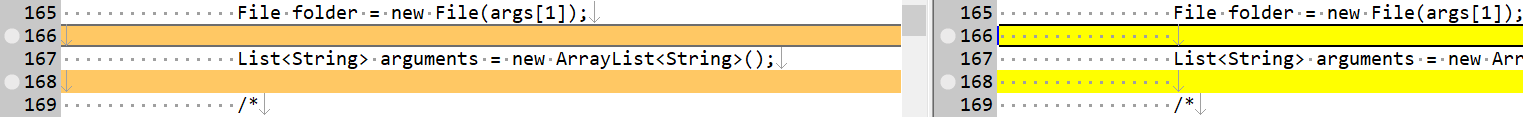

Acceleo generates a Java wrapper for each template. (I mean the wrapper derived from AbstractAcceleoGenerator class)
Each time I modify the Acceleo template, the Java file is updated and the following white spaces are added:
index.php/fa/38092/0/
When I change something in the Java wrapper itself manually, Eclipse auto removes these white spaces.
Is it possible to configure Acceleo so it will auto-remove these spaces, when the wrapper is regenerated?
The following option seems to have no effect: Windows -> Preferences -> Java -> Code Style -> Clean Up -> Remove trailing whitespace -> All lines

It seems that this option has no effect on a generated Java code. Save actions are executed only when I edit the file manually.
