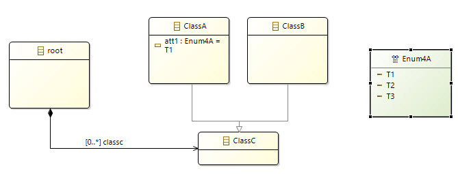

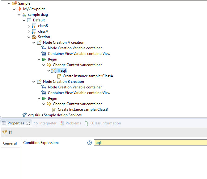

I have a situation in my metamodel just like the figure below. Now I created a graphical editor using sirius for it but I had two questions when the elements generated by the user using pallette.
metamodel:
index.php/fa/37747/0/
viewpoint file:
index.php/fa/37748/0/
1. I want when the user tries to create classA element the creation will check using an AQL query and if the element generated before the element doesn't create again. Now the problem is how could I get all of the classA instances in AQL ?????
2. In advance, how could I check the att1 attribute type in each instance and for example if the att1 is T1 the element does not create?????? how could I reach to this attribute type in instances?????

to find all the instances of a class in the same model/resource, you can use an expression like this:
aql:self.eResource().eAllContents(my::Type)
See the AQL reference documentation for more details: https://www.eclipse.org/acceleo/documentation/aql.html
