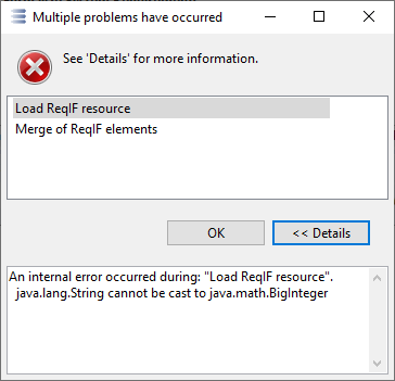

I am trying to import a .reqIF file into Capella.
Requirements have a string as identification, for example MYREQ001, MYREQ002, etc.
It seems that Capella tries to parse the identification as an integer so the import action fails.
index.php/fa/37738/0/
The same requirements work if I change the identification to 1, 2, etc.

Re: Parse string requirement ID when importing .reqIF [message #1824021 is a reply to message #1823881] Mon, 06 April 2020 11:09 Go to previous message
That was exactly the problem, thank you (sorry for not finding that thread before posting).
By removing the ForeignID import option from Preferences (Capella -> Requirements -> Importer) the requirements were properly imported.
Since I am using a notation in which the ID is the same as the Name, it is not a big problem.
I used Cameo Systems Modeler to export to ReqIF. By default it uses an integer for the ID, but it can be manually changed to a string value.
