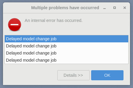

Yesterday (03/24/2020) I applied the 2020-03 updates to my 2019-12 version of Eclipse. Now I'm getting nuisance pop-panels with window title "Multiple Errors Have Occurred", content title "An internal error has occurred.", and several additional lines that say "Delayed model change job" (see attached image).
So far this is only happening when I have the debugger attached. I timed the appearances, and in my current debug session the panel(s) appear about every 5 minutes. Sometimes I get just one panel; other times I'll get a series of two or three in close succession. And they steal keyboard focus from whatever you're doing - meh.
If you click on "Details >>" it says "An internal error has occurred. Index out of bounds".

Does it show a stack trace? If not, please open the Errors view and look for a corresponding entry. If there's a stacktrace to the exception, then I suggest you file a bug. The packages of classes involved should provide a good hint at which component may be causing this.

There's no stack trace in the troublesome panel, but the Error log had one (included below). Interestingly, the problem further seems to be associated with just one of our remote debugging configurations. This particular configuration is connected to a VM that has threads coming and going for various reasons, which makes the thread list in the Debug tab dance around a bit. Maybe that's tickling this since the backtrace suggests nodes are being removed from a tree. Though... the thread activity far outpaces the seemingly regular appearance of these panels, so no clue why the appearance of them seems to be about every 5 minutes give or take.
I'll throw it over the fence to the gurus and see what they have to say.

TreeModelContentProvider.handleRemove() does some voodoo with variable 'viewIndex', which is then passed into JFace. => I recommend you file a bug against Platform/Debug.

The were quick to mark my bug 561427 as a duplicate of 561338, so the dev team is apparently getting hit over the head with it.
FWIW - and as mentioned somewhere in 561338 - if you jigger around with the thread display filters you can convince it to stop complaining. I can't say exactly what I changed there to make it stop complaining because it seems like the configuration ended up about back where I started. But anyway, if this panel is bugging anybody, try fiddling with those settings and you might get lucky.
