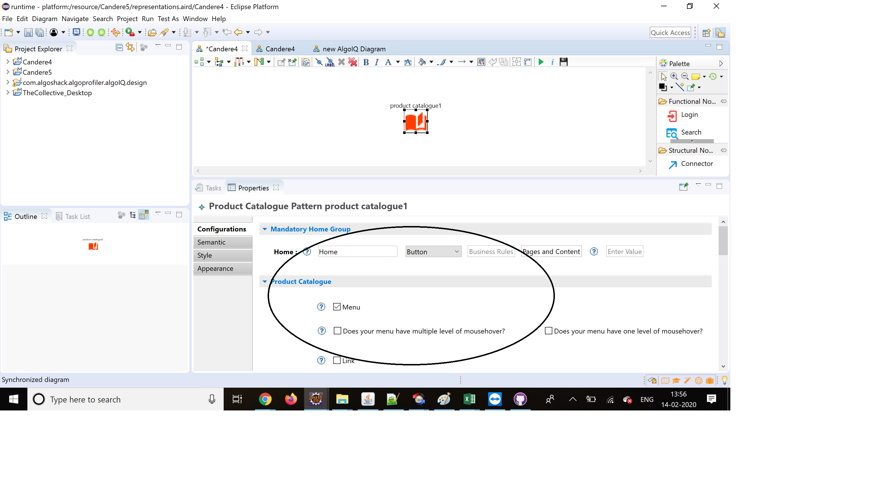

I have some elements in properties sheet that will not save some time.
As shown in the screenshot the highlighted part is not saving. we have checked for the feature name which is given correctly. I am facing this issue for a long time now and we are loosing alot of work because of that. '
Initially astrick mark will come if any changes are done after sometime that astrick mark doesnt come and the diagrams stops saving.

From the screenshot it looks like your modeler is using custom widgets. I could be wrong, but don't think the layout seen on the screenshot can be produced with the standard Sirius/EEF widgets.
If that is the case, maybe the issue is in how these widgets have been implemented? I don't remember having heard about this kind of issues when using the standard ones.
If you can reproduce the issue with only standard Sirius-provided widgets however, please open a bug.

Thanks for the reply, but I am able to reproduce the issue with standard sirius provided widgets. and me and my team is facing this issue since two years. Its becoming very difficult my team is loosing a huge amount of work because of this issue.
