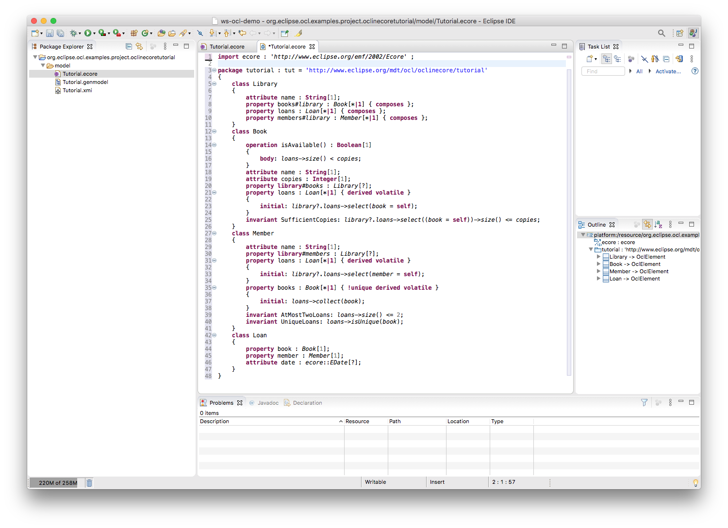

I was unfortunately not able to solve the issue yet. Here are the steps to reproduce the error on my platform:
  1. Switch to a clean, new Eclipse workspace.
  2. Add an Example > OCL (Object Constraint Language) Plug-ins > ECLinEcore Tutorial project to this workspace (org.eclipse.ocl.examples.project.oclinecoretutorial).
  3. Right click the Tutorial.ecore file to Open With > OCLinEcore Editor.
  4. Add a space at a random line and delete it again to mark the view as dirty (see the attached screenshot for an overview of the Eclipse window in this state). Ctrl+S to save the file.
  5. Open the Tutorial.ecore file using the Generic Text Editor. These are the contents of the file:
    <xmi:XMI xmi:version="2.0" xmlns:xmi="http://www.omg.org/XMI"/>
Note that I get the same behavior if I
  1. create and try to edit an OCLinEcore Ecore File in another project or
  2. if the *.ecore file is not opened in the Ecore Editor provided by EMF in the meantime.
  • Attachment: ocl-issue.png
    (Size: 314.09KB, Downloaded 128 times)
