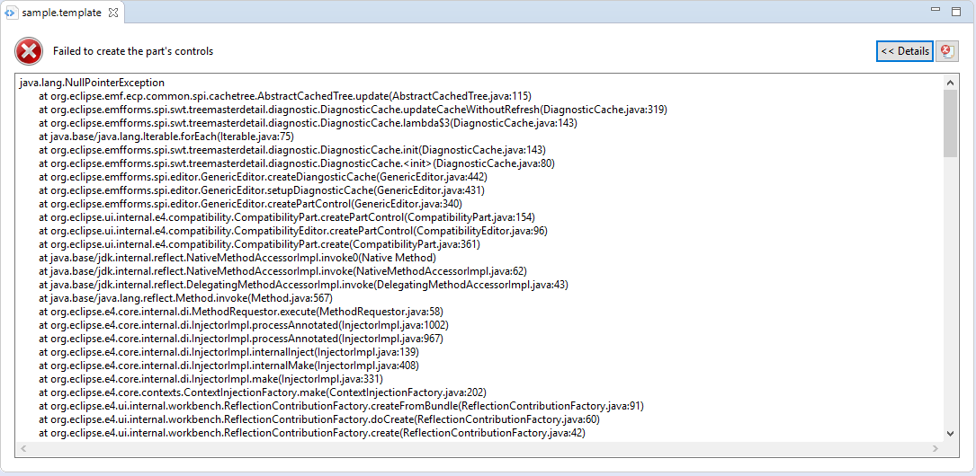

Template model editor issue [message #1821510] Thu, 13 February 2020 14:25 Go to next message
The template model editor fails to open a template model after eclipse restart.
An error printout is include below. Any suggestion on how to fix this are appreciated.
Sven
Error: Failed to create the part's controls
Error detail:

Re: Template model editor issue [message #1821863 is a reply to message #1821510] Fri, 21 February 2020 05:49 Go to previous messageGo to next message
Hi Sven,
this looks like a bug. Could you provide the template that causes the NPE in a bug report?
Best,
Eugen

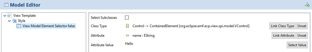

Re: Template model editor issue [message #1822183 is a reply to message #1821863] Fri, 28 February 2020 18:46 Go to previous messageGo to next message
Hi Eugen,
I have attached a file with just one view template that causes the NPE. I hope that helps.
The attribute value looks a bit odd when opening the file in a text editor, this is just an observation since I don't know how it's created/generated.
Sven

Re: Template model editor issue [message #1822266 is a reply to message #1822250] Mon, 02 March 2020 15:14 Go to previous messageGo to next message
Hi Sven,
this is a bug. I created https://bugs.eclipse.org/bugs/show_bug.cgi?id=560703 .
Could you explain your use case of the attribute field with the attribute value?

I'm using the view model element selector, with the name attribute. I commented about the attribute value looking odd in a previous post, but since it works with the view model I don't think that's an issue.
The template file is only editable in the Eclipse session in which it is created. The next time Eclipse is started the file can't be opened in the model editor. I created a very simple file with the same result, see attached screenshots.
Sorry for slow response, I missed the new message notifications.
Sven

yes I could reproduce your error and created a bug for this.
My question was why you are using this kind of selector in the template? I assume you want to change the style of a specific control? Or do you have multiple controls with the name 'Helle' ?
Because if you have exactly one, you could use the DomainModelReferenceSelector instead.

There are multiple tables in the model that should have the same view properties, it's convenient to use the ViewModelElementSelector and refer to them by name. The DomainModelReferenceSelector could also be used, however it doesn't work either, so not a viable alternative at this point.
Thanks for filing the bug report!

I filed a bug report with a sample template attached.
It seems I could only attach one file with the bug report so I'm attaching the corresponding ecore file here.
I would appreciate if you check if you can reproduce the NPE and let me know.

I cannot reproduce an error with the template model you attached.
Can you export your workspace and attach it here or on the issue?

A test model project that triggers the NPE here is attached (import as existing project) .
Please let me know how it goes.

I had a preliminary fix in my IDE, so I did not see the error.
Thank you for reporting.
I will comment on the bug as soon as I have a fix,
