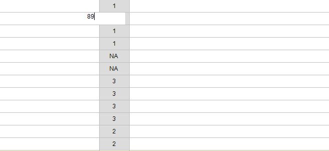

In our NAT table, we are hiding list of columns based on a button. When any of cell of this column is in edit mode & when we try to hide the column. The column are hidden but the particular cell alone is hanging in our table.
i tried to replicate the same with NAT table example, but there it is working fine.
Not sure what is root cause, if anyone point me to the right direction it would be helpful.
Attached Screenshots...
  • Attachment: Before.png
    (Size: 12.10KB, Downloaded 103 times)
  • Attachment: After.png
    (Size: 3.13KB, Downloaded 100 times)

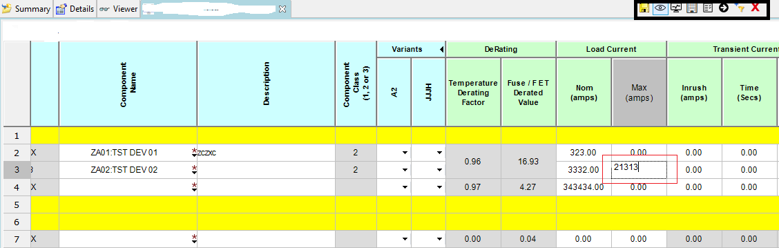

Hi Dirk,
we have nattable embedded into a view having other components. when we click on anything within the nattable then the cells that is being edited loses focus correctly and modified value is set in cell.
But instead of doing mouse click on nattable, if we click on any other widget or menu action in the view which contains the nattable, then the editable cell is not loosing focus.
i have attached a sample image to show the layout
we want the cell to loose focus and the edited value should get set in the cell everytime we do a mouse click anywhere in the UI.
Re: Modified values of a cell is getting set into other cell when columns are hidden/shown [message #1821539 is a reply to message #1821538] Fri, 14 February 2020 06:02 Go to previous message
There is no focus on a cell. If you click somewhere outside the editor it should loose focus. Especially if you click any widget outside nattable.
If it does not you need to debug in the listeners added by the AbstractCellEditor. From a picture I can't tell why it is not working in your environment while it works in all other scenarios.
