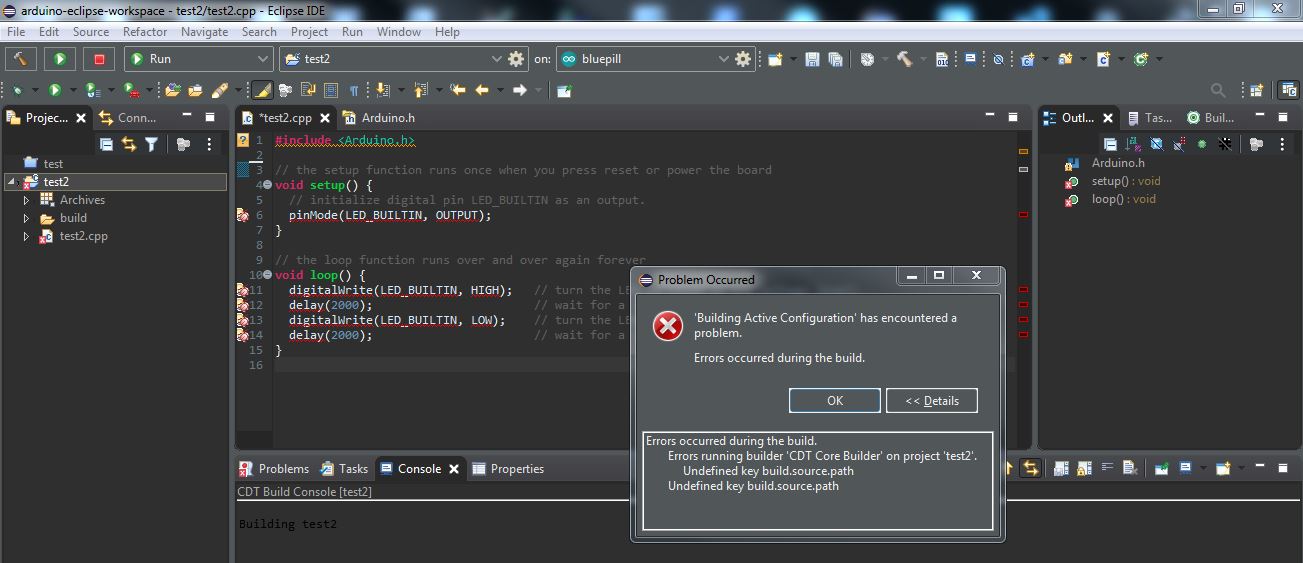

I installed the fresh eclipse C/C++ IDE 2019.
In "Preferences->arduino" I add the link for stm32 board (https://github.com/stm32duino/BoardManagerFiles/raw/master/stm32/package_stm_index.json).
In "Help"-> Arduino Download Manager, installed STM32 core.
Then i selected bluepill as New Launch Target, All of the stm32 list of MCUs appeared fine.
but when i click build the following error appears (attached).
  • Attachment: eclipse.JPG
    (Size: 100.46KB, Downloaded 237 times)

Re: problem in building arduino project with stm32 core based target selected [message #1828948 is a reply to message #1820917] Mon, 22 June 2020 23:41 Go to previous message
Same problem using stm32:
Eclipse IDE for GNU ARM & RISC-V C/C++ Developers
Version: 2019-12 (4.14.0)
This variables are used in :
.arduinocdt/packages/STM32/hardware/stm32/1.9.0/platform.txt
And not provided by Eclipse when using SMT32
