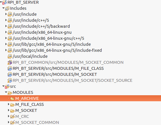

I hope I can explain this as PLAIN C++ problem.
It should be OK with Eclipse to "include" source from another project.
The idea is to have ONE place to edit (a class ) and use it independently ,
no "relations" whatsoever in other projects.
I use simple "properties .. settings .. include path ".
It shows up in
project -> includes (see attaches screen shot )
it complies . links but
show up as "undefined reference".
The icon attached to "include RPI_BT_COMMON..." has (!) and the text is grayed .
Obviously no good, but...
I cannot figure out what is wrong , what am I missing OR is "include" from another project no good.
Is including source not enough ( but it complies ) ?
Do I need to make a library and link it to my project ?
