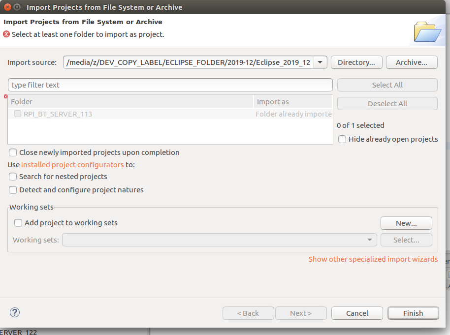

I have used "Configure and Detect Nested projects" to be able to compile two projects.
Works as expected.
I am unable to reconfigure the resulting "nest" - AKA change / remove / delete project from it.
Any pointers / help would be appreciated.
See attached screen shot

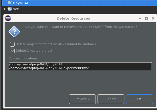

In the following, "xor" is a nested project in "tinyNEAT"
the dialog is a response to deleting "tinyNEAT"
but it will delete both if I say OK
To delete "xor" I would just delete "xor" from the workspace.
index.php/fa/37224/0/
These are only nested because they came that way.
Normally, I would avoid nesting projects.
