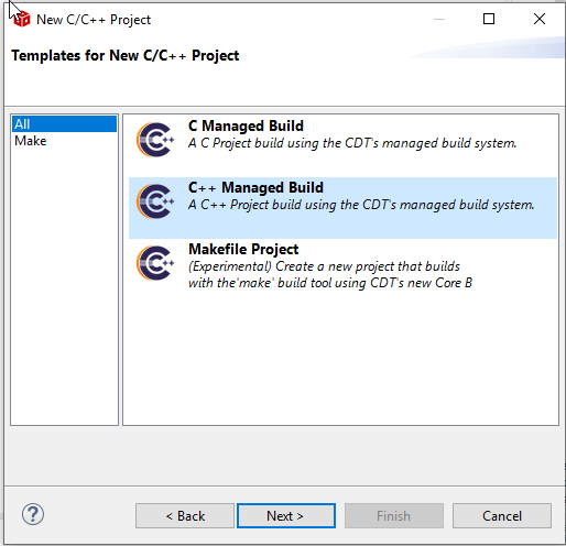

I have created a CDT C++ Managed build project. I need to be able to switch between two main cpp files (containing the main function.)
How can I do that ?
thank you

A Managed Build is restricted to one executable per project.
You need to write your own Makefile with separate targets.
You can use the Build Targets view to select the target to build.
