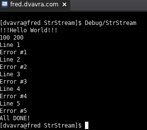

Output to Eclipse console is buffered:
index.php/fa/37077/0/
Output to a terminal is not buffered:
index.php/fa/37078/0/
I don't think there is any way to get Eclipse to tie them together.
If you want to run in the console then write a perror-like routine that sends output to cout.

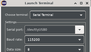

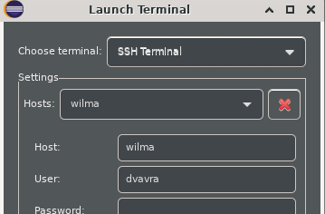

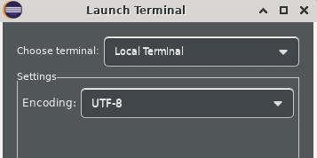

When you are running in the Raspberry, the communication is via a serial port.
That's another device in Linux.
You are communicating with the device.
Eclipse TCF (Target Communication Framework) is through the Terminal View.
This is independent of the Eclipse console.
https://marketplace.eclipse.org/content/tm-terminal
When it is started, it can connect to different things.
For the Raspberry, it connects to your serial port (which could be a USB connection).
The displays look similar but are two different things.
The image labelled "Output to terminal" above is from a Terminal View.
Some examples (Local, Serial, and SSH)
index.php/fa/37084/0/
index.php/fa/37085/0/
index.php/fa/37086/0/
