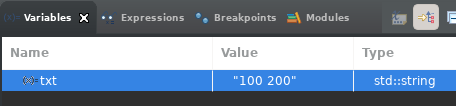

You could write it to a string stream and view the buffer.
https://stackoverflow.com/questions/5193173/getting-cout-output-to-a-stdstring
Be aware that viewing the content of a string stream isn't easy.
You could do this instead:
#include <iostream>
#include <sstream>
using namespace std;
std::stringstream ss;
int main() {
	cout << "!!!Hello World!!!" << endl; // prints !!!Hello World!!!
	ss << 100 << ' ' << 200;
	std::string txt = ss.str();
	cout << txt << endl;
	return 0;
index.php/fa/37065/0/
You can also typecast and change the display base of variables by right-clcking on them in the Variables view.
