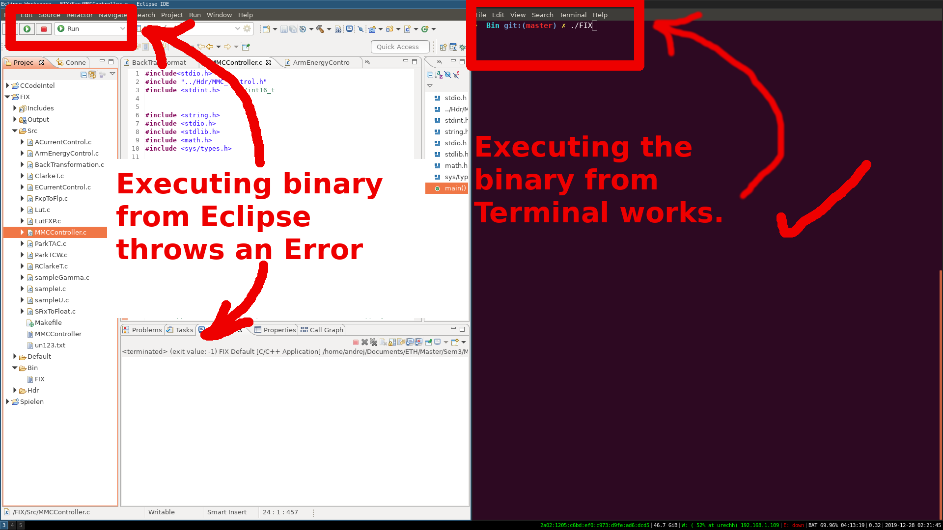

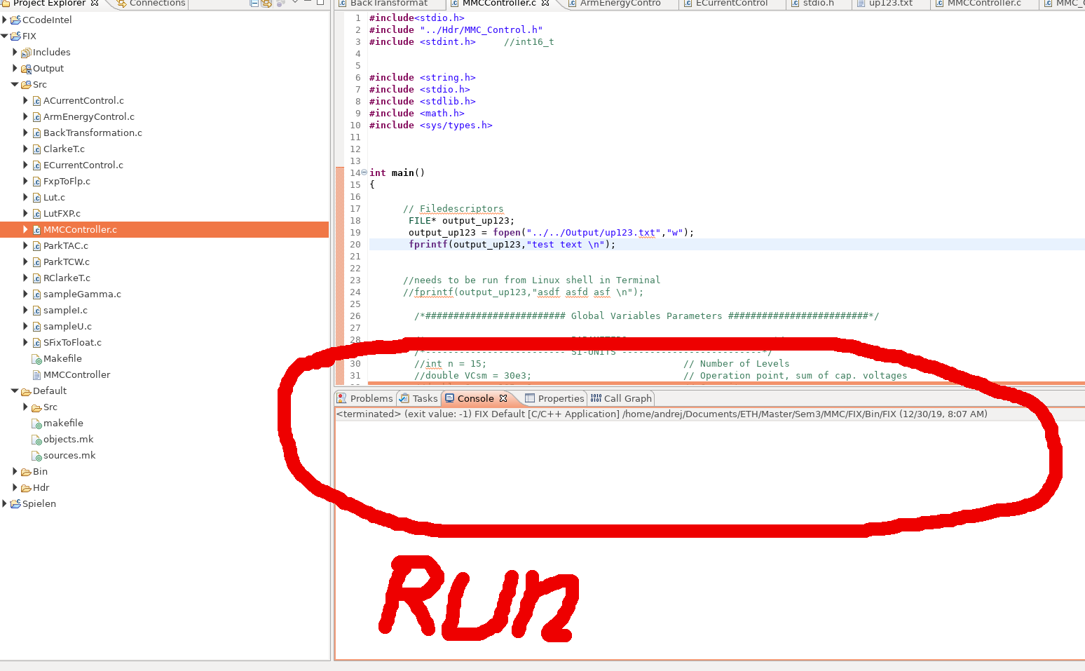

I am using eclipse 2019-09 in Ubuntu GNU Linux. For a C project I need to write Data into a file, I use a file descriptor to achieve the latter.
FILE* output_up123;
output_up123 = fopen("../../Output/up123.txt","w");
fprintf(output_up123," test text \n");
The code with the above file descriptor compiles, and does the job, but only when I run the binary from the linux shell. However, the binary cannot be run in Eclipse (see printscreen in attchment), this leds me to the conclusion that I have the change some eclipse settings, but I could not figure out, what I have been missing.
Can somebody please tell me, how I have to configure Eclipse, so that I can use file descriptors and run the binary from within Eclipse.
Many thanks in advance.
Andreas

Re: Writing in a File using a file descriptor [message #1818816 is a reply to message #1818776] Sun, 29 December 2019 23:36 Go to previous messageGo to next message
It's hard to tell what the current directories are during the execution

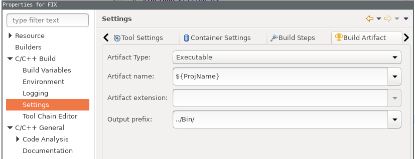

but from the Project Explorer view, the executable for FIX appears to be in directory <proj>/Bin

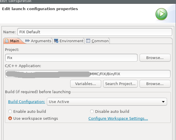

and the run launcher looks like it's trying to launch <proj>/Default/FIX.
The rest of the line in the console view probably would confirm this
but you've covered it up.
Verify that the run launch configuration is pointing to the proper executable.

Re: Writing in a File using a file descriptor [message #1818827 is a reply to message #1818816] Mon, 30 December 2019 02:38 Go to previous messageGo to next message

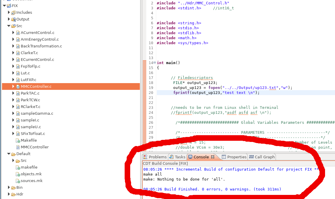

thanks for your reply. The code compiles without any error. On running the executable I get no further console output (please consider the attachments).
The executable is indeed stored in the Bin directory. But the run time settings are set accordingly. Furthermore, without the file descriptors the executable can be executed from within eclipse.
I would be grateful for further tips of how I could get eclipse to run the executable, when using the file descriptors.

Re: Writing in a File using a file descriptor [message #1818846 is a reply to message #1818827] Mon, 30 December 2019 05:38 Go to previous messageGo to next message
I dunno.

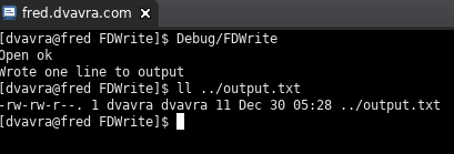

I wrote a small program to do the same (more or less) and it worked OK.
#include <stdio.h>
int main() {
	FILE *output;
	output = fopen("../output.txt","w");
	if (output == (void*)0)
		printf("Error opening output %d\n",errno);
	else
		printf("Open ok\n");
	fprintf(output,"Some stuff\n");
	printf("Wrote one line to output\n");
	fclose(output);
	return 0;
index.php/fa/37051/0/
index.php/fa/37052/0/
The negative output is an error return code.
You may be getting an error when you try to write?
Or something else in your code is returning the -1?
You forgot to return a zero?
You aren't printing anything so how do you know it didn't write the file?
You normally don't see the return code when running from a terminal.
Try changing the main temporarily to only write but print any error return like I do.

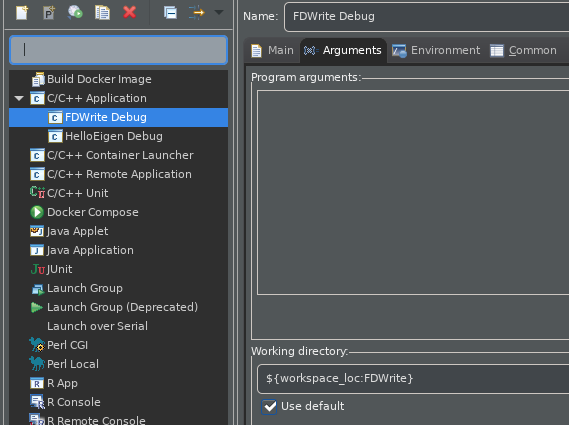

Check that the working directory in the Arguments tab is correct.
index.php/fa/37054/0/

Re: Writing in a File using a file descriptor [message #1818851 is a reply to message #1818846] Mon, 30 December 2019 07:33 Go to previous message
This was it, I did not choose the right working directory in the Arguments tab of the run time settings.
Many thanks for your help!!!
