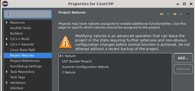

You can try adding another C Nature to the project natures.
Project --> Properties --> Project Natures
In the following example, I made a C-only project with a .cpp file.
The cpp file wouldn't compile until I added the final C-Nature.
index.php/fa/36946/0/
Removing the final C-Nature reverted to the original behavior.
