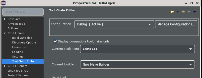

You can do this by:
  • if 4.5.3 is your system default (or is first in your execution path):
    Go to Project --> Properties --> C/C++ Build -->Tool Chain Editor
    and change "Cross GCC" to "Linux GCC" in the Current toolchain box
    index.php/fa/37097/0/

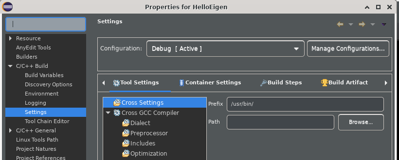

  • OR keep the chain as "Cross GCC" but change the prefix to <path to 4.5.3>/bin/ (note the trailing slash) in
    Project --> Properties --> C/C++ Build --> Settings --> Tool settings tab --> Cross Settings
    When building, the Make recipe will call <path to 4.5.3>/bin/gcc for the compiler
    In the example below it becomes /usr/bin/gcc
    index.php/fa/37099/0/
