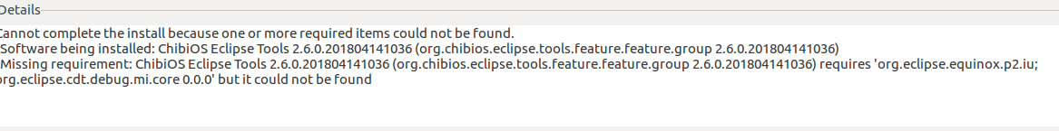

I am attempting to add ChibiOS ( add new software) to working Eclipse 2019-09. .
If fails with reference to missing "equinox" resources.
See attached file "details".
The Chibi forum goes to great length advertising that ChibiOS can indeed work with Eclipse, but only up to certain version of Eclipse - it does not include Eclipse 2019 version , thus throwing the error..
My question to this forum - can I safely install OLDER , required PART of Equinox onto current Eclipse 2019-09?
Are there any known issues doing that?
I do plan to backup my current Eclipse 2019-09 before installing the Equinox part(s).

This isn't CDT related.
Did you try the Equinox forum?
https://www.eclipse.org/forums/index.php?t=thread&frm_id=31
UPDATE:
I see you don't really want to change the Equinox code at all.
What's missing is the CDI debugger which was removed 3+ years ago.
Apparently the ChibiOS plugin code was never updated.
If you want to use this plugin you'll either have to
  • install it with a compatible version of CDT (the one with Mars?)
  • modify the plugin yourself
