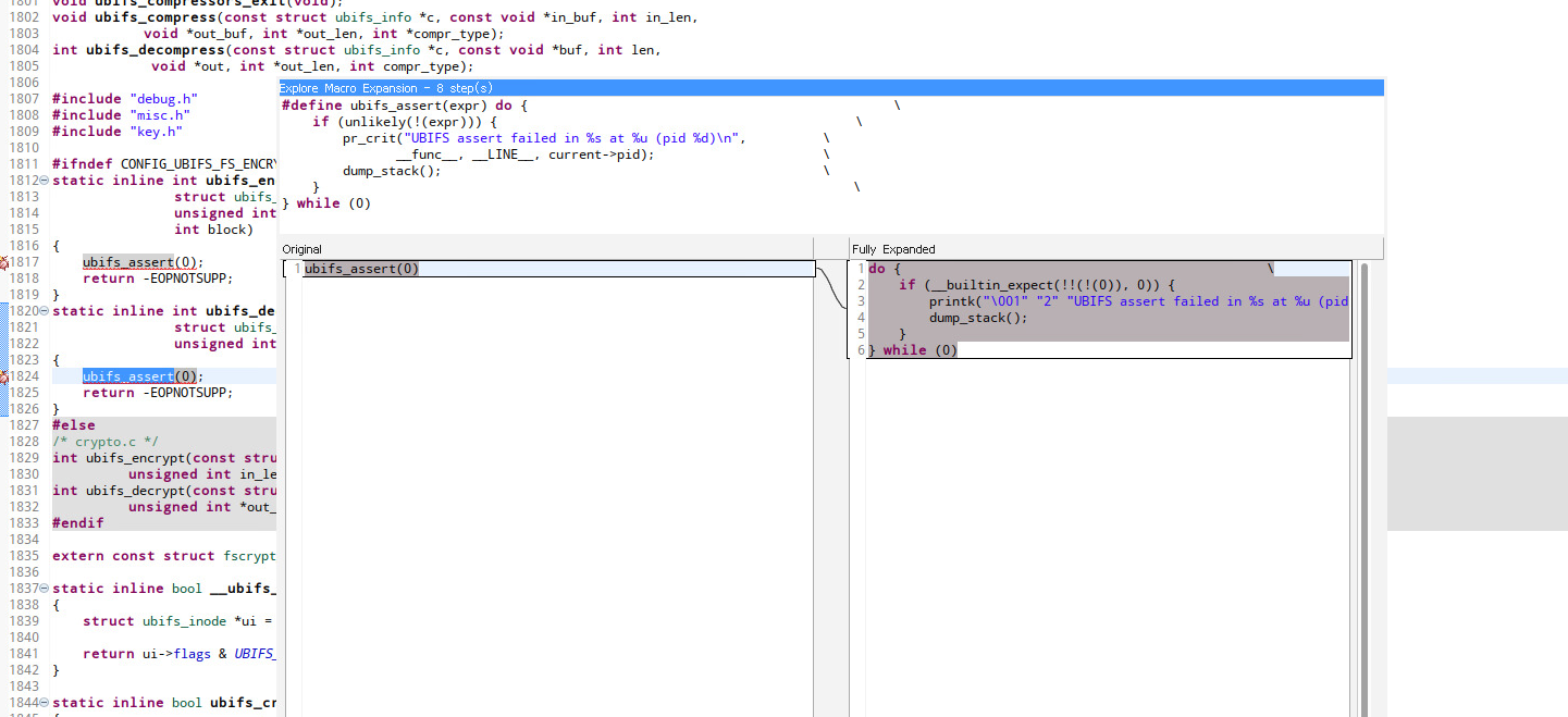

In linux kernel code, some macro can be explored by CDT, but they are indicated "could not be resolved" , see the attached screenshot.
index.php/fa/36769/0/
Is there a way to fix this issue?

Re: some macro could not be resolved but CDT can explore the macro expansion in linux kernel code [message #1817505 is a reply to message #1817420] Mon, 25 November 2019 02:34 Go to previous message
Hi David,
Thanks, the linux kernel version is 4.12.29, CDT is the latest release (9.9.0.201909091956) with Eclipse 2019-09, Problem description: Field 'ubifs_assert(0)' could not be resolved, ubifs_assert is a mcro, and defined at fs/ubifs/debug.h
There are lots of debug.h in linux kernel code, maybe the corrected debug.h is not loaded when analysis ubifs_assert mcro.
