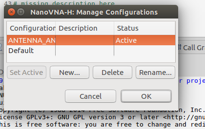

I can change project configuration .
Unfortunately I have to have BOTH default and ANTENNA ANALYSER to successfully build the project.
It does work, but only once.
It looks as there can be only one active configuration , not a combination of two I need.
How can I save it , make permanent?

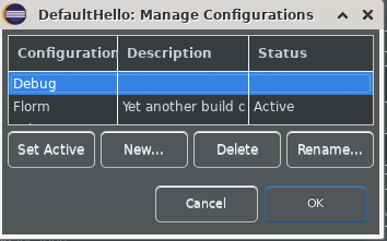

Not sure what you mean by "permanent".
The build configuration in Eclipse is just a different build directory.
This really only applies to Managed Builds.
The build directory for the configuration won't exist until it is built.
Then it's part of the project.
Note: Eclipse managed builds can only handle a single executable or library creation.
You will need to use your own makefile with a Makefile project if you want something else.
Build configurations in a Makefile project can be done but need some thought.
