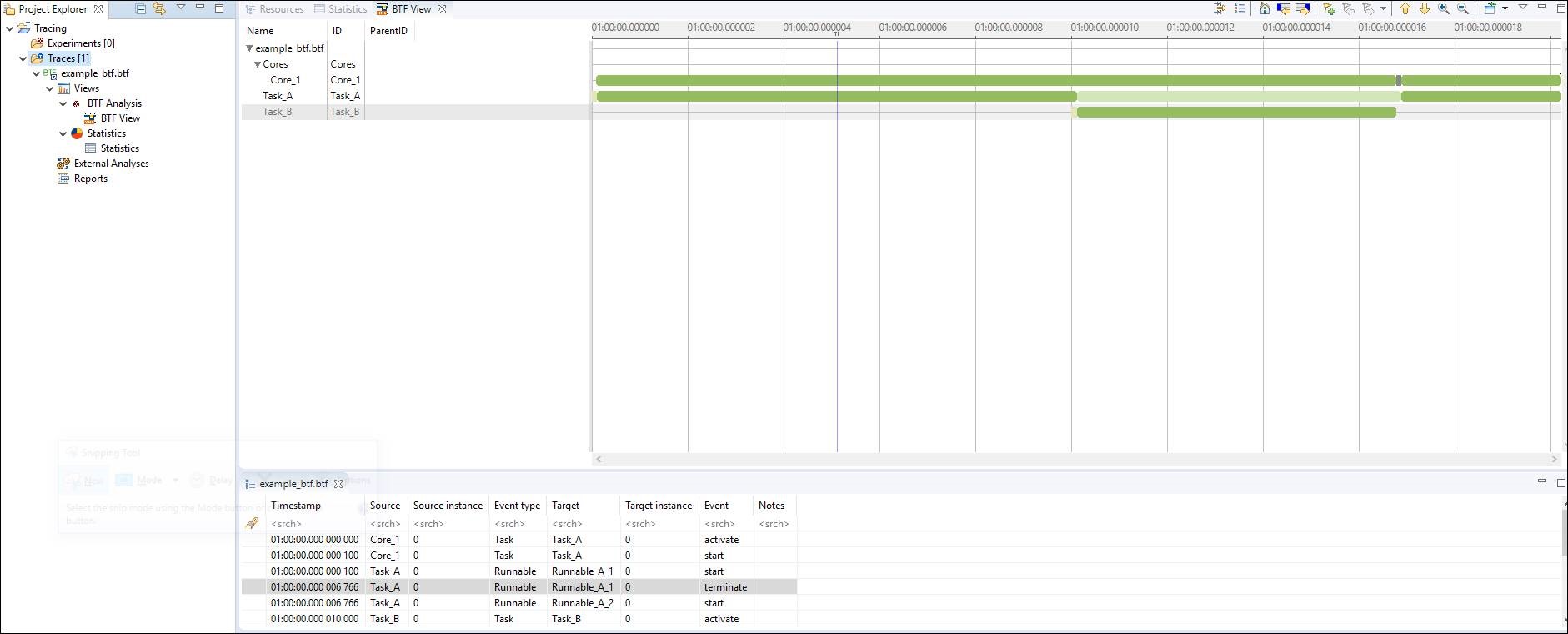

In the BTF view, I don't see the runnables. I used the example from the BTF specification. I only see the TASK. I have attached the file also. I am using the latest version of tracecompass 5.10. I am running windows 10 64 bit.

Interesting, this looks like something that was never been implemented.
Here is the evidence.
https://i.imgur.com/gdMosHh.png
We can get it to work, could you please open a bug. - OR - if you feel like implementing it we will gladly review it for you. :)
