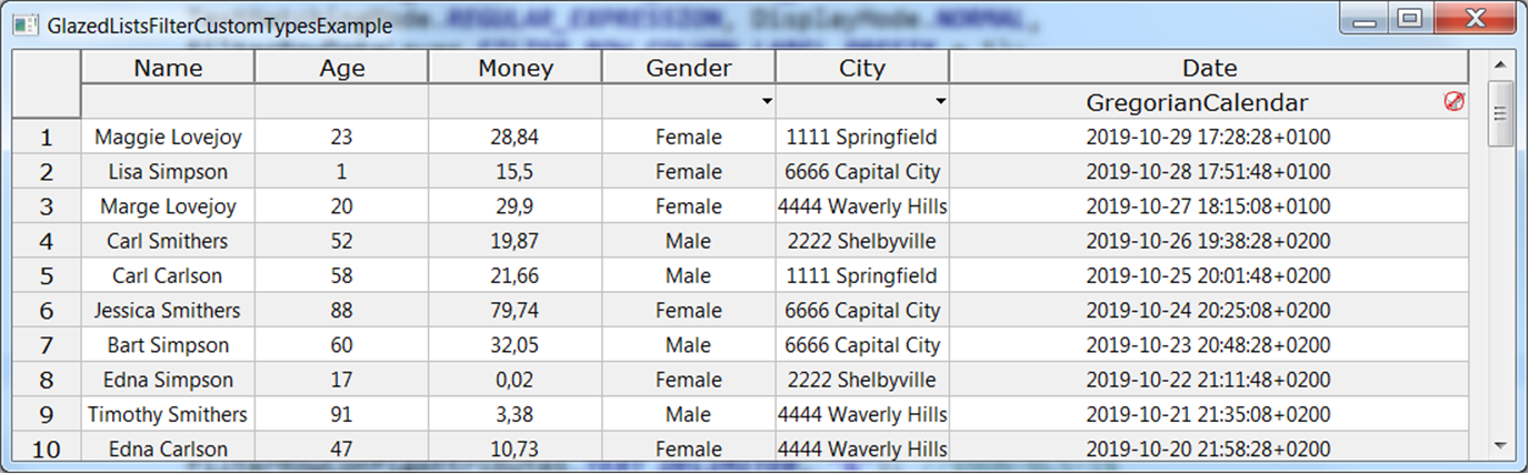

Re: Filter converted data [message #1816463 is a reply to message #1816271] Tue, 29 October 2019 13:00 Go to previous messageGo to next message
To illustrate my issue, I have attached a modified _6032_GlazedListsFilterCustomTypesExample.java in which I have added an extra "Date" column that will hold a java.util.Calendar object.
In it, I have pasted my aforementioned converter, "CalenderTimeToTextConverter", to get the desired output in the cells of the Date column.
On top of that, I have configured the TEXT_MATCHING_MODE:
configRegistry.registerConfigAttribute(
    FilterRowConfigAttributes.TEXT_MATCHING_MODE,
    TextMatchingMode.CONTAINS, DisplayMode.NORMAL,
    FilterRowDataLayer.FILTER_ROW_COLUMN_LABEL_PREFIX + 5);
Now I would like to use the FilterRow cell in the Date column to search for the strings that I see in the Date column, but as you can see from this screenshot, in reality it searches the output of Calendar.toString(). Otherwise it would not have matched the string, "GregorianCalendar":
index.php/fa/36674/0/
Please see my two attached files: "Modified_6032_GlazedListsFilterCustomTypesExample.java" and "string_search_in_date_column.png".
What should I do to make my FilterRow work against the formatted strings that I see in the Date column?
Re: Filter converted data [message #1816492 is a reply to message #1816463] Wed, 30 October 2019 02:36 Go to previous messageGo to next message
