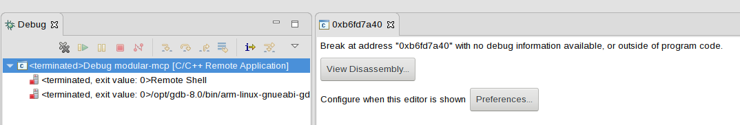

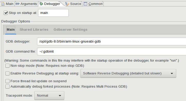

When I call same gdb from Eclipse I see this output in Eclipse debugging console
GNU gdb (GDB) 8.0
Copyright (C) 2017 Free Software Foundation, Inc.
License GPLv3+: GNU GPL version 3 or later
*** cannot insert links
This is free software: you are free to change and redistribute it.
There is NO WARRANTY, to the extent permitted by law.  Type "show copying"
and "show warranty" for details.
This GDB was configured as "--host=x86_64-pc-linux-gnu --target=arm-linux-gnueabi".
Type "show configuration" for configuration details.
For bug reporting instructions, please see:
Find the GDB manual and other documentation resources online at:
For help, type "help".
Type "apropos word" to search for commands related to "word".
(gdb) 0xb6fd7a40 in ?? () from target:/lib/ld-linux-armhf.so.3
I see only difference that there are no messages like this
Reading /user/etc/modular-mcp-debug from remote target...
in Eclipse console...
Debugging is terminated with this message
Break at address "0xb6fd7a40" with no debug information available, or outside of program code
Please see attached screenshots from my Eclipse (2019-06, running on Debian 9.8.2)
