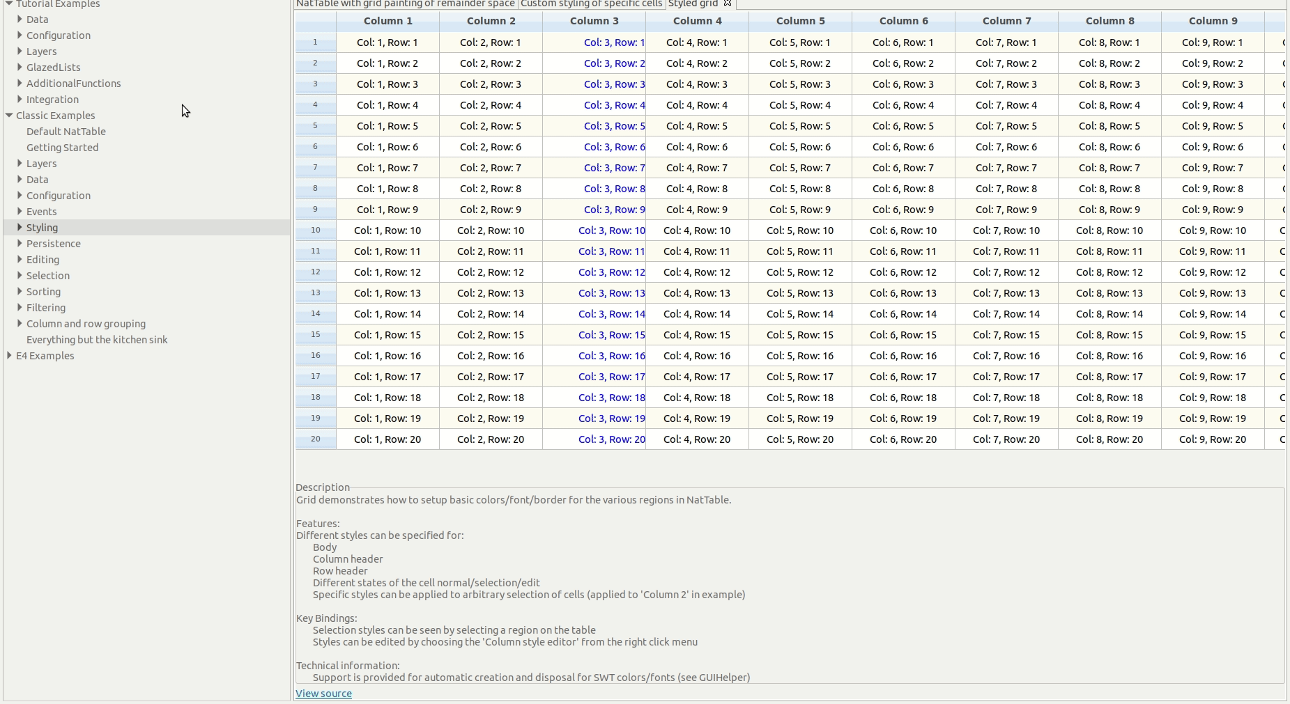

First you should only update one thing at a time to better understand which update is causing this. Although I am not really sure what you see as an issue. The animated gif only shows our examples and for me it looks OK. Or what do you want to show with that gif?
We fixed some scaling issues with NatTable 1.6. So maybe it is related to that if you have enabled scaling on your system.

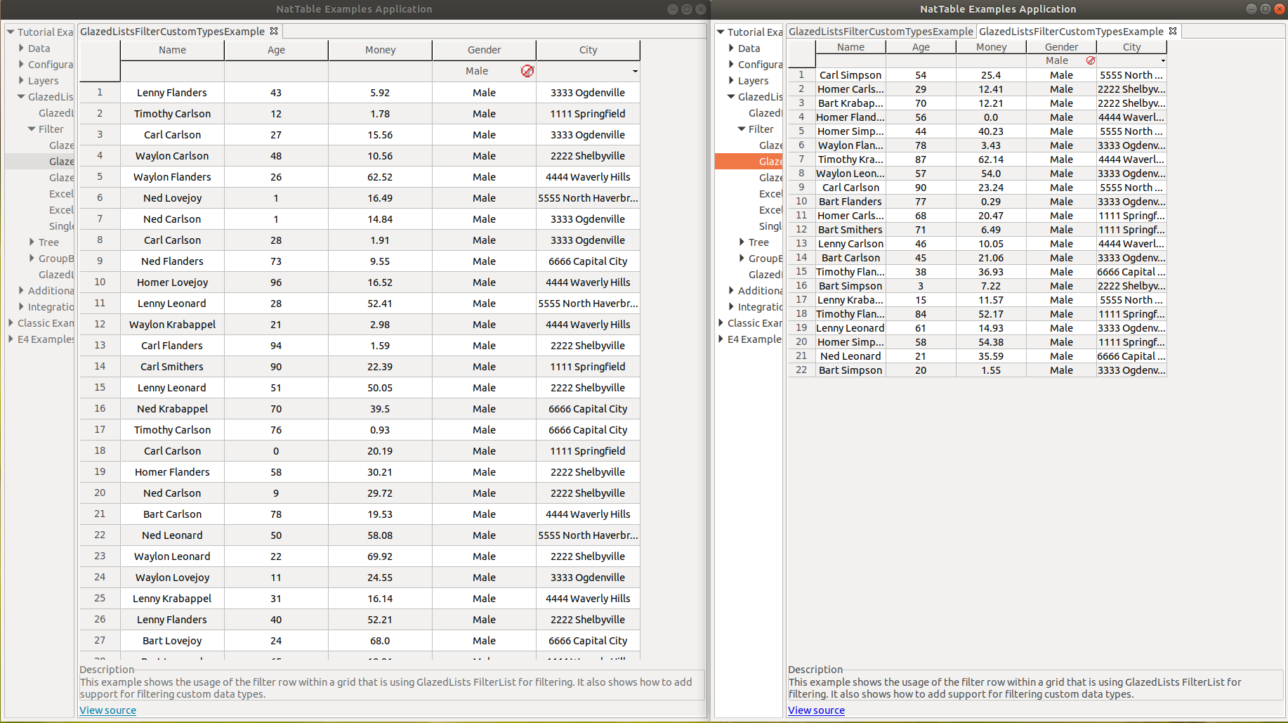

Hi Dirk,
Thanks again, yes now I have reverted back to v1.5 , but the scaling problem is still present, I have check out nattable branch with tag 1.5.0 , and use eclipse 19-09 to run the product. the result is on the left side, whereas the samples application downloaded is in the right side of the attached image [Comparision_Nattable.png], I think scaling is done automatically, i have not changed the setting in ubuntu .
See the size of filter icon that is also distorted.
