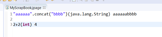

Re: Cannot connect to socket - new to java/eclipse [message #1817410 is a reply to message #1810071] Thu, 21 November 2019 12:41 Go to previous messageGo to next message
No problem here !
Thank for the the knowledge....
System: windows 10
Java: openjdk 13.0.1
Eclipse 2019-09 R (4.13.0)
index.php/fa/36803/0/

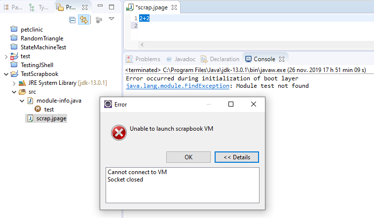

Re: Cannot connect to socket - new to java/eclipse [message #1817625 is a reply to message #1817410] Tue, 26 November 2019 16:30 Go to previous message
index.php/fa/36825/0/Ok, just updated my OpenJDK t& Eclipse
openjdk version "13.0.1" 2019-10-15
OpenJDK Runtime Environment (build 13.0.1+9)
OpenJDK 64-Bit Server VM (build 13.0.1+9, mixed mode, sharing)
Eclipse IDE for Enterprise Java Developers.
Version: 2019-09 R (4.13.0)
Build id: 20190917-1200
And still have the same issue...
