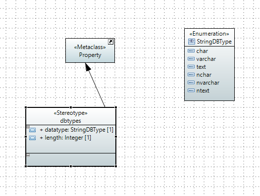

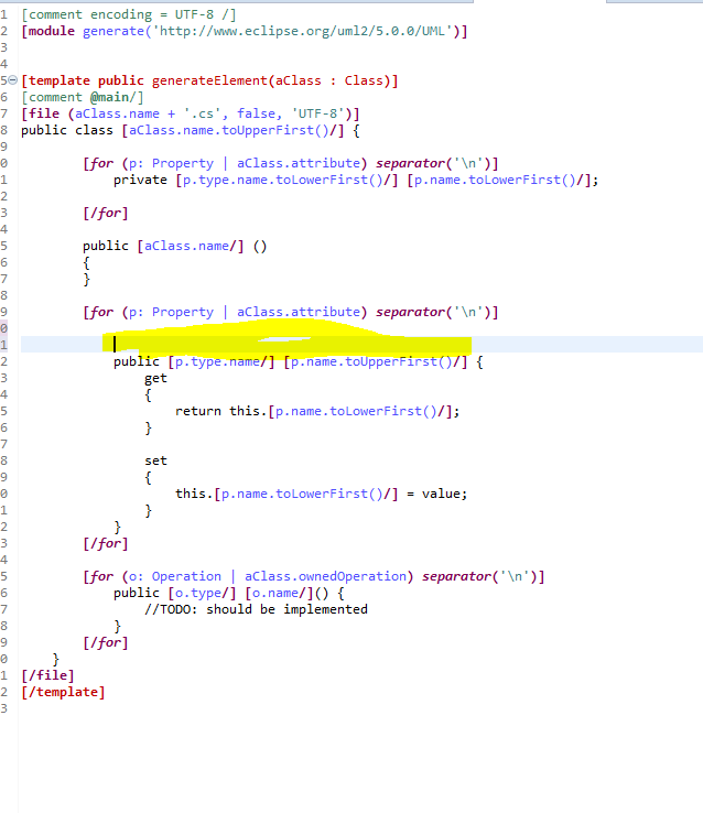

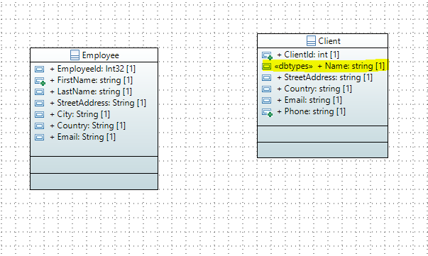

Thanks Ed Willink you alway help me very well. Your given link help me.
i used the following code and it resolved my problem very well
[ '[' /]Column(TypeName = "[p.getTaggedValue(p, p.getApplicableStereotype('PropertiesProfile::dbtypes').qualifiedName, 'datatype')/]([p.getTaggedValue(p, p.getApplicableStereotype('PropertiesProfile::dbtypes').qualifiedName, 'length')/])")[ ']' /]
[query public getTaggedValue(stereotypedElement : Element, stereotypeName : String, propertyName : String) : OclAny =
let stereotype : Stereotype = stereotypedElement.getAppliedStereotype(stereotypeName) in
if not stereotype.oclIsUndefined() then
if propertyName ='datatype' then
stereotypedElement.getValue(stereotype, propertyName).oclAsType(EnumerationLiteral).name
else
endif
else
null
endif/]
Thanks again for your help
