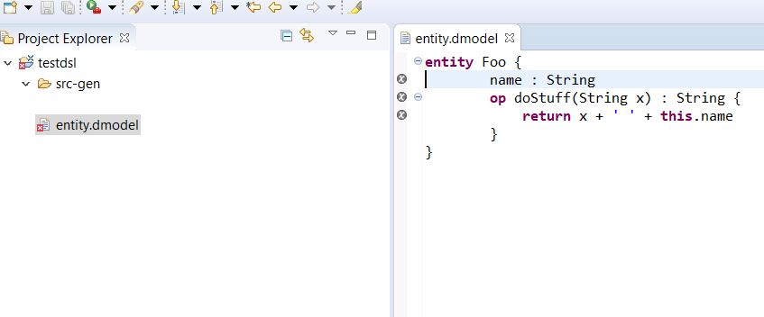

index.php/fa/35715/0/Hello everybody,
When i run example project and define simple entity , everything works fine.
But if I add String type. I get gray error ans nothing is generated.
But in Unit Test i don't get any error.

If you use xbase your model project should be a Java project and the model files should reside in a sourcefolder
