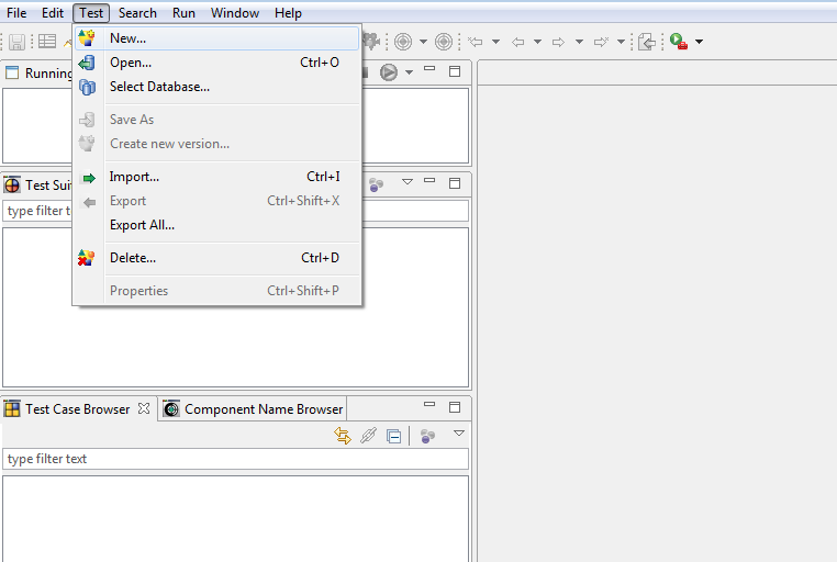

I try to running Jubula-core on eclipse to develop new test cases and toolkits, i built the project using build.xml, Building was successful, but not all dependencies was installed, i installed them manually. now Jubula project run correctly but when i choose one of the test panel : new test, open, select DataBase, import, export or Delete an exception occurred.
index.php/fa/35624/0/

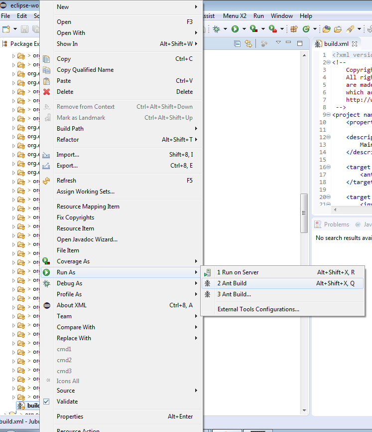

There are more than the org.apache.commons.collections bundles are missing, so i added them manually.
I used the Ant Build (Run as Ant Build) on the eclipse to build the Build.xml file.
index.php/fa/35654/0/
I cloned the project from GitHub: https://github.com/eclipse/jubula.core
You'll find the Build.xml file attached below.
Nizar
