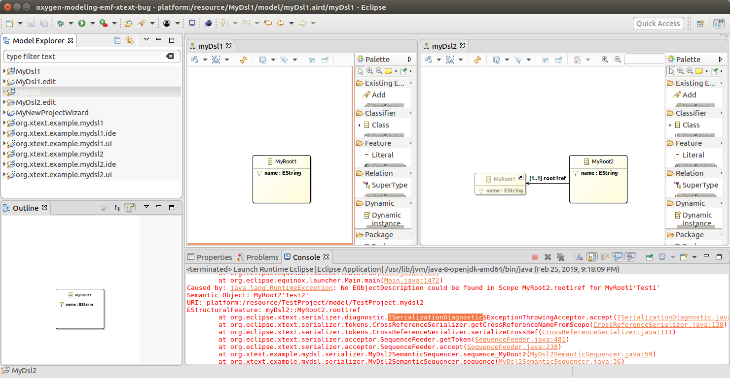

Caused by: java.lang.RuntimeException: No EObjectDescription could be found in Scope MyRoot2.root1ref for MyRoot1'Test1'
Semantic Object: MyRoot2'Test2'
URI: platform:/resource/TestProject/model/TestProject.mydsl2
EStructuralFeature: myDsl2::MyRoot2.root1ref
	at org.eclipse.xtext.serializer.diagnostic.ISerializationDiagnostic$ExceptionThrowingAcceptor.accept(ISerializationDiagnostic.java:131)

	at org.eclipse.xtext.resource.XtextResource.doSave(XtextResource.java:386)
	at org.eclipse.emf.ecore.resource.impl.ResourceImpl.save(ResourceImpl.java:1430)
	at org.eclipse.emf.ecore.resource.impl.ResourceImpl.save(ResourceImpl.java:999)
	at mynewprojectwizard.WizardMyNewProject.saveEMFModelInResource(WizardMyNewProject.java:205)
	at mynewprojectwizard.WizardMyNewProject.createModels(WizardMyNewProject.java:152)
	at mynewprojectwizard.WizardMyNewProject.access$2(WizardMyNewProject.java:131)
	at mynewprojectwizard.WizardMyNewProject$1.run(WizardMyNewProject.java:104)
	at org.eclipse.jface.operation.ModalContext.runInCurrentThread(ModalContext.java:437)
	... 46 more
I interpret the error such that the MyDsl2 model does not find the reference to MyDsl1 model. The strange thing is, that if I comment the sleep command back in, then this error does not occur. I spent a lot of time debugging and analyzing the problem and came to the following conclusion. The problem seems to be related to the Java-based resolution of the Xtext cross references. I have found out that a Java project creates the bin folder into which the new xtext models are somehow copied (automatically) at some point. I don't know which of the magic Eclipse background process does this, but obviously, the Xtext resource is not aware of this update and fails each time it tries to resolve the former resource that has not yet been created in the bin folder.
Well, obviously, the solution with sleep is a very bad solution. My question now is, how can I ensure that resource-saving runs in sync with the workspace, or what can I do else to fix my problem? My secondary question is: Do I need to use something different to IRunnableWithProgress (e.g. some transactional editing domain)? Did I maybe overlooked some obvious solution?
I appreciate any help!
Alex
Re: Error saving an EMF model with Crossreferences in a new XtextResource [message #1803253 is a reply to message #1803251] Mon, 25 February 2019 16:21 Go to previous messageGo to next message
you should use the same resourceset and make sure it uses XtextLiveScopeResourceSetProvider to create it
Re: Error saving an EMF model with Crossreferences in a new XtextResource [message #1803255 is a reply to message #1803253] Mon, 25 February 2019 16:32 Go to previous messageGo to next message
Wow, I have injected the XtextLiveScopeResourceSetProvider and it seems to have solved my problem. Thank you very much, this is quite a trick that I have missed to find. But what is this resource-set provider doing differently, and why is it not injected by default?
Re: Error saving an EMF model with Crossreferences in a new XtextResource [message #1803258 is a reply to message #1803255] Mon, 25 February 2019 16:43 Go to previous messageGo to next message
cause for read usescases it makes no sense
Re: Error saving an EMF model with Crossreferences in a new XtextResource [message #1803259 is a reply to message #1803258] Mon, 25 February 2019 16:54 Go to previous message
Ok, thanks again. You saved my day. ;-)
