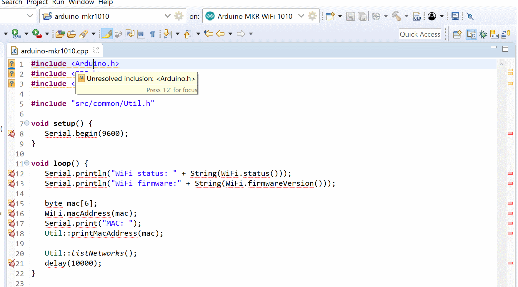

I am using Eclipse IDE for C/C++ Developers version 2018-12 (4.10.0).
I have an issue using the board "Arduino MKR WiFi 1010", of the "Arduino SAMD Boards (32-bits ARM Cortex-M0+)" platform version 1.6.20.
The indexer is unable to scan properly the SAMD platform headers referenced by my code. When I #include <Arduino.h>, I obtain the warning "unresolved inclusion". This behaviour seems an indexer issue, as the compiler works as expected and compiles succesfully the project.
If I change the board type of the project to "Arguino/Genuino UNO" or "Adafruit ESP32 Feather" and run Index -> Refresh all files, I don't have any issue.

I am using a "MKR-ZERO" (which is also included in the "Arduino SAMD Boards (32-bits ARM Cortex-M0+)" package) and experiancing the same problem. I tried to solve the problem by creating a dummy project with the source files as linked resources. I discovered that the source files are just incorrect (meaning an indexer can't possibly make sence of it, obviously).
I posted it on the bugzilla forum [issue 550084] and linked all the relating topics as well. Unfortunatly all issues (older than 3 years) on there are unattended. So hopefully someone will at least take a look at things?
